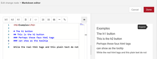

Rather than creating new node types, would it be useful to tweek the recent "has description" badge so that it displays a tooltip on hover?
The tooltip could be restricted to show only lines from the description which use the h1, h2 or h3 buttons:

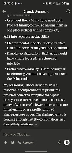

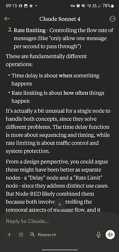

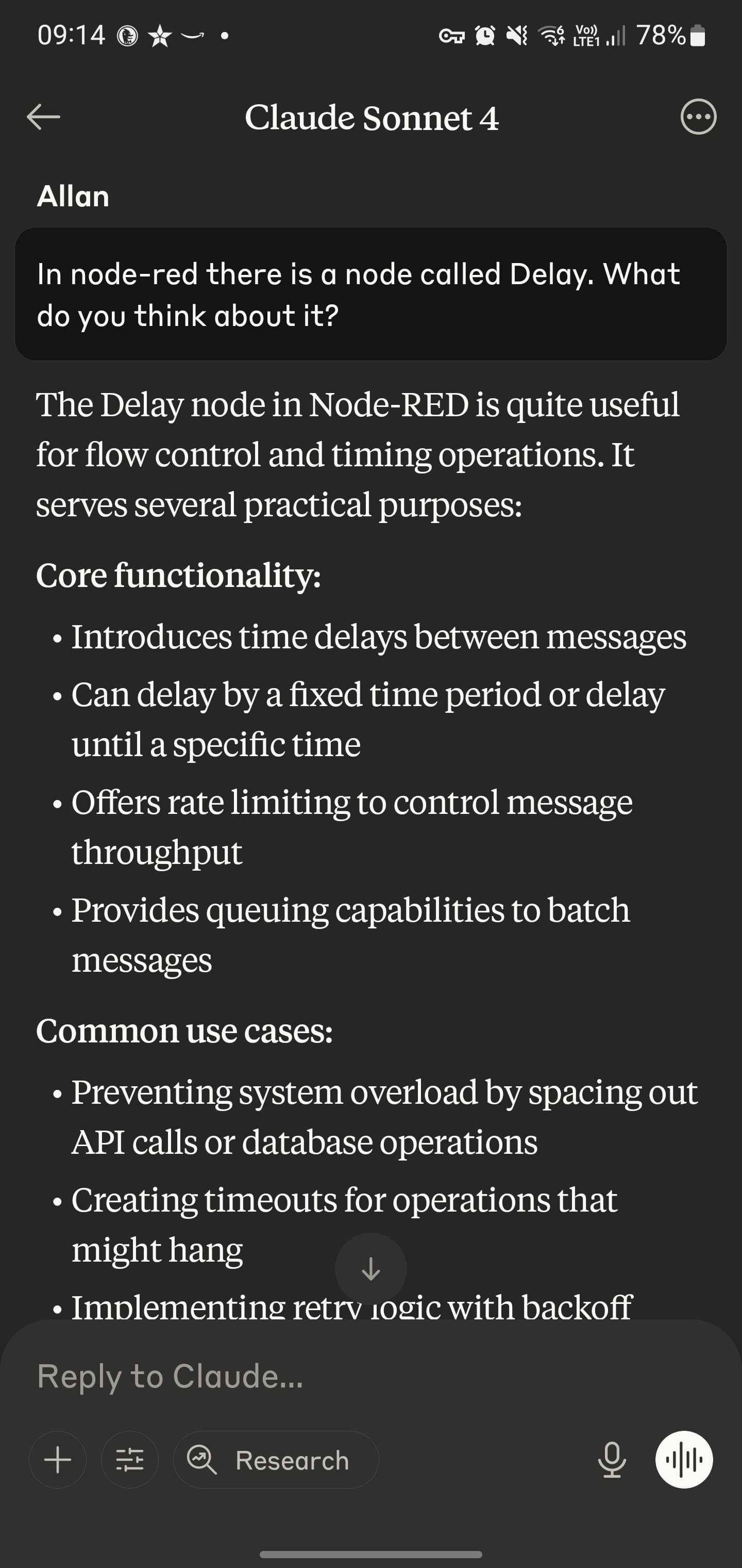

Chatgpt and Claude Sonet 4 think like me. I see the same reasoning and maybe it is because I only have less than a year using node-red. This is a UX test that that guy working for Flowfuse could run to prove this hypothesis
I cant upload the last print. So this is its conclusion.
"Naming Confusion: "Delay" really only describes one of the two functions accurately.Your preference actually reflects standard practices in many other systems. For example, in programming frameworks, you typically see separate functions for sleep()/delay() versus throttle()/rateLimit().
The current design might have been a pragmatic choice to keep Node-RED's palette smaller, but from a pure design standpoint, your instinct for separation makes perfect sense. It's good design intuition, not bias!"
Maybe both AIs are just being "sycophantic" even when I asked non biased questions. Can't be sure.
They both argue they could be separate - or could be combined. It is a design choice… we chose to combine them. Both options are right. Currently the humans are in control…
After I asked Claude to be honest it agreed with the current design. Now im not sure if it was really being "honest" or if it decided to follow my instructions literally.
So... forget about this proposal :smiling_face_with_tear:
But if you have capacity to test my hypothesis with users (new and experienced) it would be better
They try to please, and are indeed led by the questioner.
