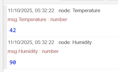

I'm guessing that you want an output something like this?

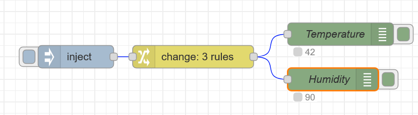

Try this flow
[{"id":"2b1db6cff0ff0516","type":"inject","z":"cd7e020b78297f7a","name":"","props":[{"p":"payload"},{"p":"topic","vt":"str"}],"repeat":"","crontab":"","once":false,"onceDelay":0.1,"topic":"dining/dht1","payload":"{\"temperature\": 42, \"humidity\": 90}","payloadType":"json","x":305,"y":120,"wires":[["02e17b25343f8689"]]},{"id":"eed0e334329a42d4","type":"debug","z":"cd7e020b78297f7a","name":"Temperature","active":true,"tosidebar":true,"console":false,"tostatus":true,"complete":"Temperature","targetType":"msg","statusVal":"Temperature","statusType":"auto","x":655,"y":90,"wires":[]},{"id":"02e17b25343f8689","type":"change","z":"cd7e020b78297f7a","name":"","rules":[{"t":"delete","p":"topic","pt":"msg"},{"t":"move","p":"payload.temperature","pt":"msg","to":"Temperature","tot":"msg"},{"t":"move","p":"payload.humidity","pt":"msg","to":"Humidity","tot":"msg"}],"action":"","property":"","from":"","to":"","reg":false,"x":460,"y":120,"wires":[["eed0e334329a42d4","e3d2e85561651a6a"]]},{"id":"e3d2e85561651a6a","type":"debug","z":"cd7e020b78297f7a","name":"Humidity","active":true,"tosidebar":true,"console":false,"tostatus":true,"complete":"Humidity","targetType":"msg","statusVal":"Humidity","statusType":"auto","x":645,"y":150,"wires":[]}]
