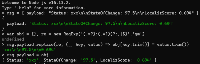

If you have no control over the format of that text then here is a small function that should help.
Function to split lines of colon separated text into a JS Object
var obj = {}, re = new RegExp('(.*?):(.*?)(?:,|$)','gm')
msg.payload.replace(re, (_, key, value) => obj[key.trim()] = value.trim())
msg.payload = obj
Proof...
