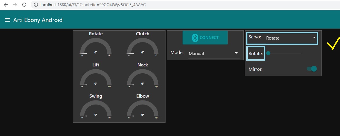

I used a single slider to control six gauges. Based on the servo (gauge) selected, the label and value of slider change. This works perfectly throughout except for a minor issue ie when I change the servo (gauge) and do not change the slider (happens only initially ie when the slider value is 0 ), the slider label does not change to next selection. Enclosing the flow which is still under dev (sorry for size as this is for the mobile screen). Kindly try selecting Manual mode.

Enclosing pics to reflect the issue
When it works
Once it's a problem
(I edited your flow so it would import)
so to reproduct this
  1. move the slider (rotate) to some value
  2. in the Servo pulldown, select 'Lift' - the slider changes to 'Lift' - and move the slider
  3. next in the pulldown select 'Neck' - the slider changes to 'Neck' - but do not move the slider
  4. next in the pulldown select 'Clutch' - note the slider name remains 'Neck' but if you move the slider, the 'Clutch' guage moves.
