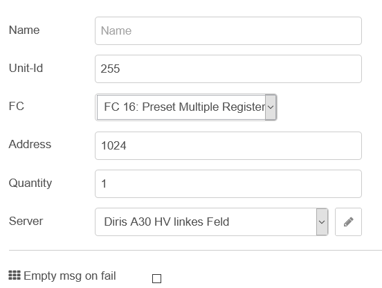

No, becaus I don't know where I have to set the 0x0002 there:
By using FC16, I miss a Field for set the offset. Like shown above,
whats the meaning of quantity? Exactly I need to set Bit 1 of the word
at address 1024.

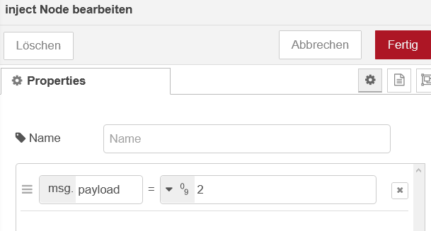

Solved !!!:
Modbus write have to set as single register and the inceted payload is the value in decimal.
0x0002 is 2 decimal.
