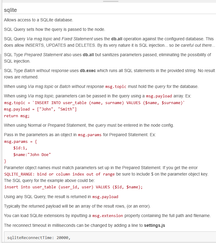

Just change your function node Insert universal data To:
msg.topic = "INSERT INTO universal_data (topic, value, timestamp) VALUES ($topic, $value, $timestamp)";
msg.payload = ["sim800_rssi", -87, Date.now()];
On the right panel there is a help which describe how to use the node.
