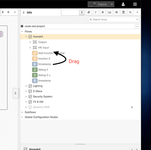

Whilst I could be wrong - the current execution order can be guessed via the right panel.
what could work, is having the ability to drag priority
