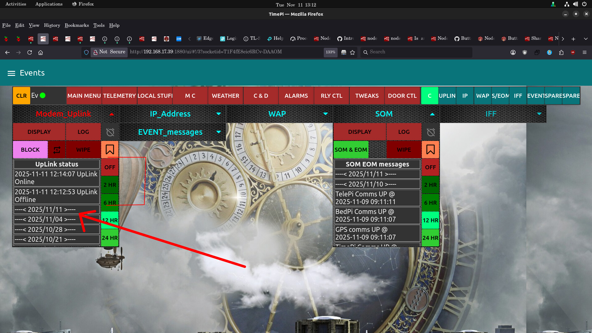

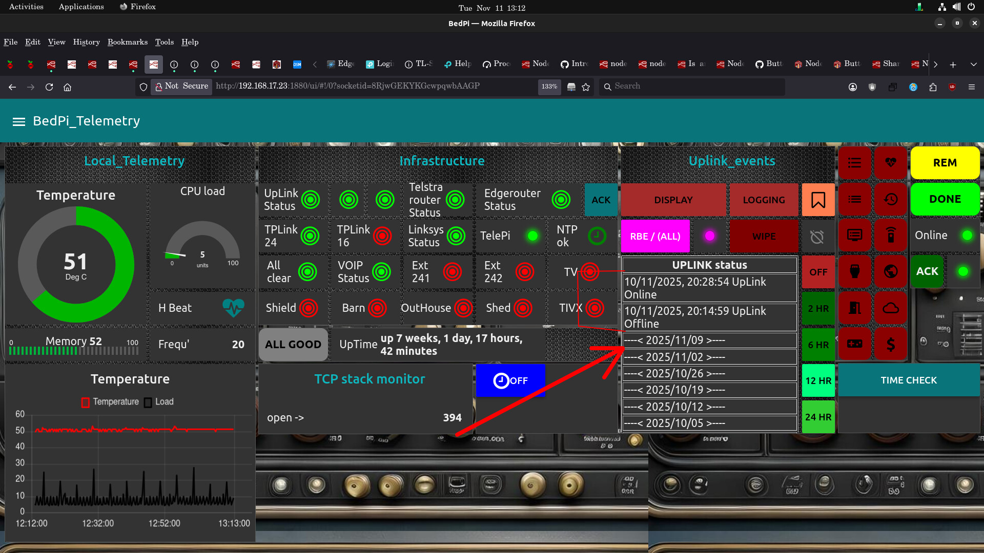

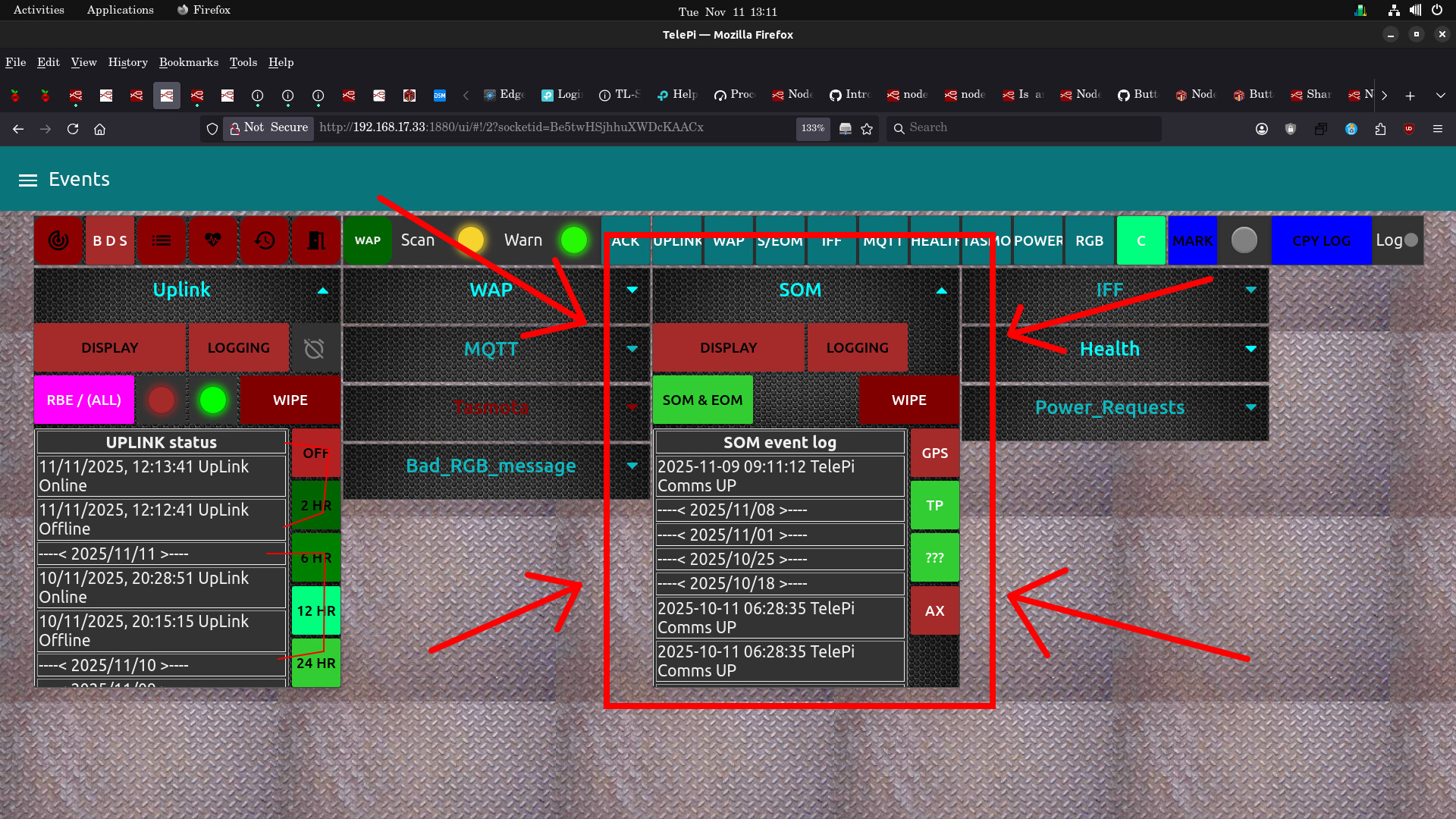

Just to (maybe) help, here are some screen shots to show you what I'm seeing.
This is the annoying one.
See the two UPLINK messages.
1 yesterday.
1 today.
(relatively speaking)
So, what's the problem?
The other two machines.
You see today's but not yesterdays.
And lastly.
You can again see today's but not yesterday's.
Which - to me - means the first (shown) machine is somehow mucking up.

To recap:
YESTERDAY'S Uplink failure is the one in question.
It only showed on one machine.
(Though, this could be partly due to the fact that the coding wasn't sharing what it saw/sees if the uplink went down, the other two would have complained all the same)
The reports are confusing.
Yesterday 2 machines said the uplink went down and their times concur.
Today 2 machines said the uplink went down and their times concur, but they are a different two than yesterday's two. (Ok, one is common..... c'mon. There's only 3 machines.)
To me that is even more confusing.

(3 screen shots I hope.) :wink:
Nothing exciting really happens. Just me, logging useless stuff.

Not wanting to go too far off topic, but from a previous day when this sort of happened but only 1 machine said the internet was down.
When I went to a terminal and tried to ping (sorry traceroute) the IP address it didn't go too far.
I can't remember the exact IP addresses, but it got to the route (I think) and became 127.0.0.x I think.
Oh dear!
I just saw that my IP address WAS changed.
But this reflects when I rebroadcasted the nw IP address. NOT when it changed.
Which was (Probably) at 03:46:31 when the uplink went offline.
Ok, yeah. That's when it went off line, not when I got the new IP address.
I'll have to look into that part too.
