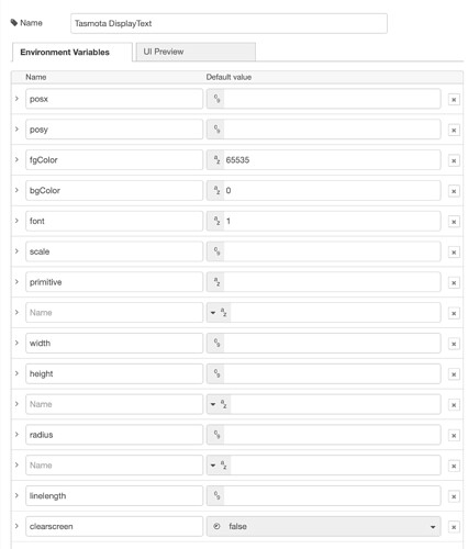

additional requests:
  • add a field duplication option in the subflow environment variables, it is a lot of work to populate 2 select boxes with the same values but with different fieldnames.

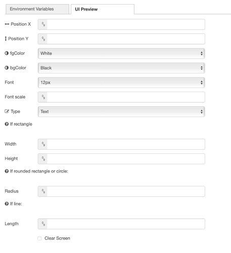

  • if the field type is set to none, it produces a span <span> </span> with a space in between, which causes an empty space to be printed below, would be a bit nicer without the empty space:
Hi, Can you clarify where exactly this name field is ? Both the subflow edit properties name field and a subflow instance name field are already much wider than 100px.
(and I don't recognise one with Foreground Color mentioned)
These properties are set in the environment variables in a subflow (there they end up with 100px).
I changed them to fgColor and bgColor instead, example
