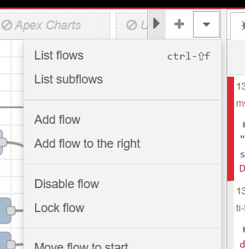

  8. Ideally, it would also have a visible UI in the Editor as browser-style fwd/back buttons. Perhaps on the left-hand side of the tab row (since the RHS already has other widgets). The visible widgets could be made optional if enough people think that it would clutter the display too much.
  9. Fwd/Back should also be listed in the tab menu on the RHS of the tab bar (maybe also on the right-click menu for tabs? Not sure about that though).
