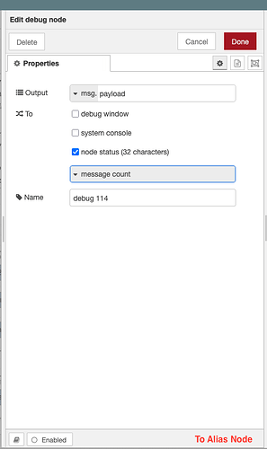

How to get a debug that only counts? The simplest thing to do is create that configuration and then use the export dialog to get at the modified json object:
        "id": "7e5745a7cb5c1179",
        "type": "debug",
        "z": "326616b4e24eab2a",
        "name": "debug 1",
        "active": true,
        "tosidebar": false,
        "console": false,
        "tostatus": true,
        "complete": "payload",
        "targetType": "msg",
        "statusVal": "",
        "statusType": "counter",
        "x": 1262,
        "y": 168,
Ironically, the best UI for alias node is actually NR itself. If the node config had a "to alias node" button:
But again, that button would also suffer from the "it's not that simple for all attributes" issue - the catch node cannot be defined with a default set of nodes - for example.
