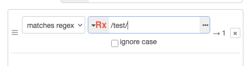

but what I don't like is that the space for entering the regex is somewhat small and hard to see what is going on - hard to edit and debug - and almost by definition when you start using groups the regex will get large quickly.

Something like JSONata editor and ellipse but for regular expressions ... which then opens the can of worms of - perhaps - creating a reg expression editor akin to the jsonata editor....
It would probably find a lot of interest if something like https://regex101.com/ or reg-visualizer - Visual Studio Marketplace was integrated into NR!
