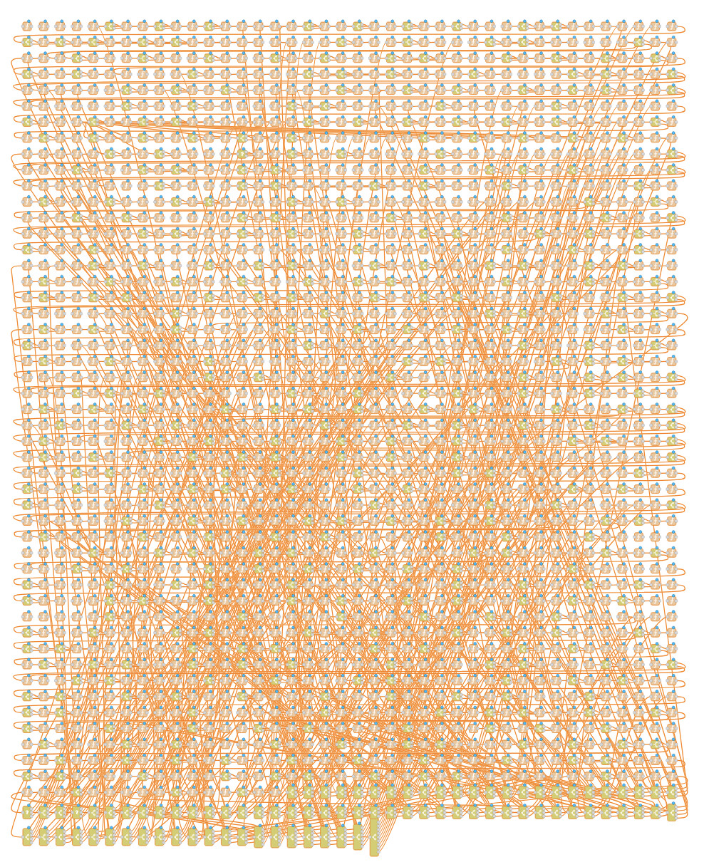

Just as an aside, I'm currently working with a large and confusing codebase. I'm trying to identify particularly complicate bits of code, so that they can be refactored. What I have done is began to visual the Abstract Syntax Tree (AST) as flows:
what is shown are the branches of switch/case and if statements but using minified nodes (hence all the same size). That flow is a (part) visualisation of 20k lines of Erlang.

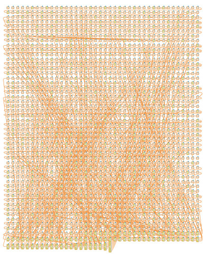

Why? Because I can visual 20k lines of code in a single flow:
(Note: bottom right is a case/switch statement with many branches ... hm?)
Now the fun bit is that this is a flow and I can send messages through this flow - so my representation of Erlang code is Node-RED and is executable. Eventually this NR code will generate the Erlang code again.
