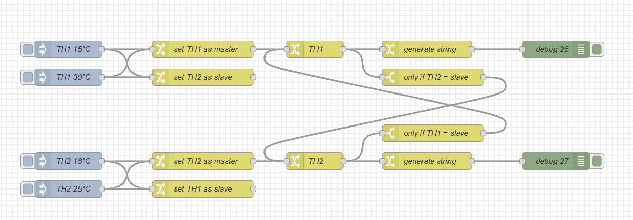

I found an approach based on a context status (which distinguishes which of the thermostats is master/slave). Let me know if there is a more better, more clever solution. Since this is also a situation which I need to solve for own purposes...

Hello,
It works for me!!!
I understand how it works.
My approach was two automatically switching gates that alternately open the query "A" and send it to "B" and then open the other gate. This was done with a time delay so that both thermostats have the same temperature.
I almost understand your solution. It works, and that's crucial. Thank you very much.
