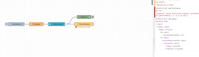

I only whant to switch on a relay if the energy price is low, so I copyed a script of a guy witch is working with the Demo Tibber Access token. But if I replace this Token with my own, than the script stops working.
That's the script with the error codes:
The Problem is, that I have two homes in my tibber App, so the querry node is sending two price informations to the Price resiver node.
How do I change the "Template-Node" so, that the "query-Node" only puts out prices for home 1 ?
Thanks for your help.
Greatings Phil
Without an example flow it is hard to be sure.
You could just move msg.payload.viewers.homes[1] to msg.payload.viewers.homes using a change node after the tibber noide
