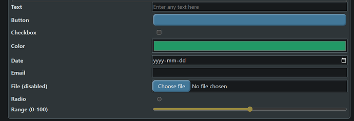

<labeled-input>
Creates an accessible, labeled user input. Currently, any type allowed by the HTML <input> tag is supported (eventually some compound inputs may also be supported). The label is easily moved to above, below, left, or right of the input simply by adding the corresponding class name. It defaults to above (e.g. a vertical layout which is the most common).
As you can see, a left or right layout automatically aligns the inputs/labels. A set of CSS variables is used to allow full and easy control of the layouts.
At present, still some things you need to do for yourself like attaching change event functions but not only do these work as you would expect, there are comprehensive examples on the demo page for you to borrow. Documentation is reasonably complete as well.

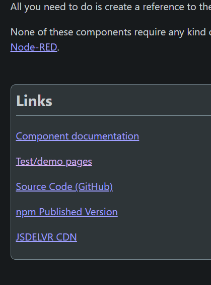

Would it be possible to change the colour of the links. My eyes are not what they used to be and I have to get close to see the text?

Hi there, hmm, those do look bad! But that isn't how they look on my system:
What browser are you using?
I deliberately don't touch the colour of links in my CSS so that you can set them at the browser. However, perhaps I should set them?
I will add a CSS variable perhaps with the default being to use the browser's choice. But then you will be able to easily override it. For the live website, I will tweak the link colours shortly since that is forced into dark mode.
@Buckskin - try the live wc.totallyinformation.net site now. I've updated the styles.
Thank you. Much better (although I am not a big fan of pink / purple :grin:). I am using Edge.
