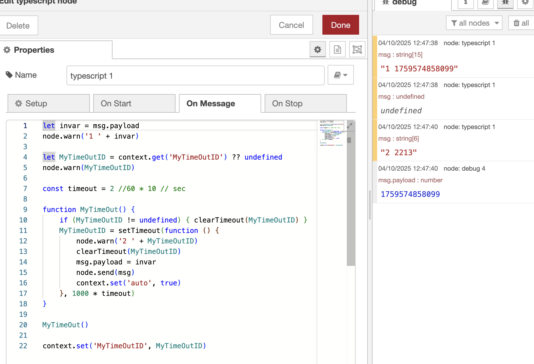

Hi,
I just fixed the issue in version 1.2.6.
Here's a screenshot of my test.
It hadn't been added to Manage Palette yet, so I downloaded it via npm.
All good now.
