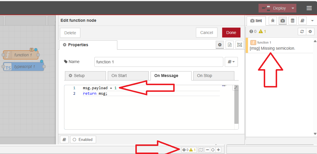

The linting and formatting I got working in normal function node works ok-ish. It will show some stuff in code editor. I can get more alerts in bottom bar. And it will do some light formatting most of the time, perhaps on paste or newline (enter).
For ts node, I get the formatting, but none of the linting. It may be easier to show because it’s difficult to explain precisely the user experience I’m talking about:
Here I have same code in function node and typescript node. Only function node reports on linting.
Ideally, the user experience would be even better if closer to vscode, for example format on save and showing exactly where in code the lint rule is triggered. But I can make due with this alert. ts node doesn’t even have that (or I have not been able to apply it).
