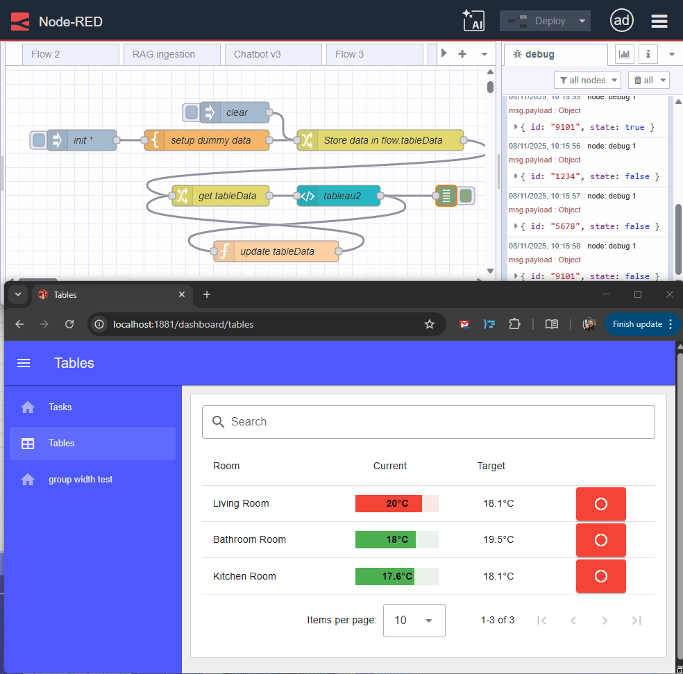

Hi, welcome to the forum.
There are some vue concepts in your code you are missing (this.value is a single state and why your individual rows were not updated).
Anyhow, rather than go through that all, I will post an altered version of your flow that uses context to maintain state server side & only updates client side if the backend has received the new state (i.e. front end reflects state of backend for end to end state true state reflection)
Perhaps it will help you achieve what you need?
Here goes.
The flow:
[{"id":"dcf53187a96c3ca4","type":"ui-template","z":"ab58ae07fd1bce02","group":"26de8d07b6d3a7d8","page":"","ui":"","name":"tableau2","order":1,"width":0,"height":0,"head":"","format":"<template>\n    <!-- Provide an input text box to search the content -->\n    <v-text-field v-model=\"search\" label=\"Search\" prepend-inner-icon=\"mdi-magnify\" single-line variant=\"outlined\"\n        hide-details></v-text-field>\n    <v-data-table v-model:search=\"search\" :items=\"msg?.payload\" :headers=\"headers\">\n        <template v-slot:item.target=\"{ item }\">\n            <!-- Add a custom suffix to the value for the \"target\" column -->\n            {{ item.target }}°C\n        </template>\n\n        <template v-slot:item.current=\"{ item }\">\n            <!-- Render a Linear Progress Bar for the \"current\" column -->\n            <v-progress-linear v-model=\"item.current\" min=\"15\" max=\"25\" height=\"25\" :color=\"getColor(item)\">\n                <template v-slot:default=\"{ value }\">\n                    <strong>{{ item.current }}°C</strong>\n                </template>\n            </v-progress-linear>\n        </template>\n        <template v-slot:item.button=\"{ item }\">\n            <!-- Add a custom suffix to the value for the \"target\" column -->\n            <!-- Any HTML can go here -->\n            <v-btn :color=\"item.state ? 'green' : 'red' \" stacked @click=\"toggle(item)\">\n                <v-icon>{{item.state ? 'mdi-power' : 'mdi-power-off'}}</v-icon>\n            </v-btn>\n        </template>\n\n    </v-data-table>\n</template>\n\n<script>\n    export default {\n    data () {\n      return {\n        search: '',\n        headers: [\n            { title: 'Room', key: 'room', align: 'start' },\n            { title: 'Current', key: 'current', align: 'center' },\n            { title: 'Target', key: 'target', align: 'center' },\n            { title: '', key: 'button', align: 'center' }\n        ]\n      }\n    },\n    methods: {\n                // add a function to determine the color of the progress bar given the row's item\n        getColor: function (item) {\n            if (item.current > item.target) {\n                return 'red'\n            } else {\n                return 'green'\n            }\n        },\n        toggle: function (item) {\n            this.send({\n                payload: {\n                    id: item.id,\n                    state: !item.state // invert\n                }\n            });\n        }\n    }\n\n}\n</script>\n","storeOutMessages":true,"passthru":false,"resendOnRefresh":true,"templateScope":"local","className":"","x":480,"y":320,"wires":[["2ac571404b6a93d5","2c95426efe2fc9bf"]]},{"id":"88f79f61142b3dd0","type":"inject","z":"ab58ae07fd1bce02","name":"init","props":[{"p":"topic","vt":"str"}],"repeat":"","crontab":"","once":true,"onceDelay":0.1,"topic":"","x":110,"y":240,"wires":[["7235c71551dc6882"]]},{"id":"fb285de370f1bc42","type":"inject","z":"ab58ae07fd1bce02","name":"clear","props":[{"p":"payload"},{"p":"topic","vt":"str"}],"repeat":"","crontab":"","once":false,"onceDelay":0.1,"topic":"","payload":"[]","payloadType":"json","x":330,"y":200,"wires":[["ee8bf75e9248dca9"]]},{"id":"7235c71551dc6882","type":"template","z":"ab58ae07fd1bce02","name":"setup dummy data","field":"payload","fieldType":"msg","format":"json","syntax":"mustache","template":"[\n    {\n        \"room\": \"Living Room\",\n        \"id\": \"1234\",\n        \"target\": 18.1,\n        \"current\": 20,\n        \"toto\": 10,\n        \"button\": 1,\n        \"state\": false\n    },\n    {\n        \"room\": \"Bathroom Room\",\n        \"id\": \"5678\",\n        \"target\": 19.5,\n        \"current\": 18,\n        \"toto\": 10,\n        \"button\": 0,\n        \"state\": false\n    },\n    {\n        \"room\": \"Kitchen Room\",\n        \"id\": \"9101\",\n        \"target\": 18.1,\n        \"current\": 17.6,\n        \"toto\": 10,\n        \"button\": 2,\n        \"state\": false\n    }\n]","output":"json","x":290,"y":240,"wires":[["ee8bf75e9248dca9"]]},{"id":"ee8bf75e9248dca9","type":"change","z":"ab58ae07fd1bce02","name":"Store data in flow.tableData","rules":[{"t":"set","p":"tableData","pt":"flow","to":"payload","tot":"msg"}],"action":"","property":"","from":"","to":"","reg":false,"x":540,"y":240,"wires":[["9d6449a8cc36a5b5"]]},{"id":"9d6449a8cc36a5b5","type":"change","z":"ab58ae07fd1bce02","name":"get tableData","rules":[{"t":"set","p":"payload","pt":"msg","to":"tableData","tot":"flow"}],"action":"","property":"","from":"","to":"","reg":false,"x":310,"y":320,"wires":[["dcf53187a96c3ca4"]]},{"id":"2ac571404b6a93d5","type":"function","z":"ab58ae07fd1bce02","name":"update tableData","func":"\nconst tableData = flow.get('tableData')\nconst itemId = msg.payload.id\nconst foundItem = tableData.find(e => e.id === itemId)\nif (!foundItem) {\n    node.warn(`Item with ID ${itemId} not found!`);\n}\nconst targetState = !!msg.payload.state\nconst currentState = !!foundItem.state\nif (currentState === targetState) {\n    // no change\n    return null // halt flow\n}\n\nfoundItem.state = targetState\nflow.set('tableData', tableData)\n\nreturn msg;","outputs":1,"timeout":0,"noerr":0,"initialize":"","finalize":"","libs":[],"x":390,"y":400,"wires":[["9d6449a8cc36a5b5"]]},{"id":"2c95426efe2fc9bf","type":"debug","z":"ab58ae07fd1bce02","name":"debug 1","active":true,"tosidebar":true,"console":false,"tostatus":false,"complete":"payload","targetType":"msg","statusVal":"","statusType":"auto","x":635,"y":320,"wires":[],"l":false},{"id":"26de8d07b6d3a7d8","type":"ui-group","name":"Table examples","page":"f01f7f9fa8bf747e","width":"6","height":"1","order":1,"showTitle":false,"className":"","visible":"true","disabled":"false"},{"id":"f01f7f9fa8bf747e","type":"ui-page","name":"Tables","ui":"03482f22997a66ac","path":"/tables","icon":"table","layout":"notebook","theme":"0d92c765bfad87e6","order":2,"className":"","visible":"true","disabled":"false"},{"id":"03482f22997a66ac","type":"ui-base","name":"My Dashboard","path":"/dashboard","appIcon":"","includeClientData":true,"acceptsClientConfig":["ui-notification","ui-control","ui-chat"],"showPathInSidebar":false,"headerContent":"page","navigationStyle":"default","titleBarStyle":"default","showReconnectNotification":true,"notificationDisplayTime":1,"showDisconnectNotification":true,"allowInstall":false},{"id":"0d92c765bfad87e6","type":"ui-theme","name":"Basic Blue Theme","colors":{"surface":"#4d58ff","primary":"#0094ce","bgPage":"#eeeeee","groupBg":"#ffffff","groupOutline":"#cccccc"},"sizes":{"pagePadding":"12px","groupGap":"12px","groupBorderRadius":"4px","widgetGap":"12px"}},{"id":"74bcbabb7199aa26","type":"global-config","env":[],"modules":{"@flowfuse/node-red-dashboard":"1.29.0"}}]
Demo:
chrome_aybvwfAH61
