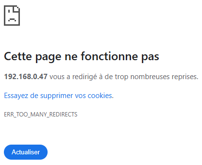

I just upgrade my Node-Red platform to 4.1.0 on my Raspberry 5 and then I get stuck with UiBuilder to get access to my UiBuilder dashboard.
I did the complete cleaning of the cookies like requested in the message, no way. It’s the same situation with other browser. I uninstall uibuilder and install it again. No way. No error message in Node-Red logs telling a problem somewhere or in relation to UIBUILDER.

Hi, this is not a cookie issue. Something is causing a redirect of your selected URL to something else and is then looping.

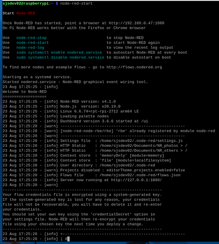

It would be useful to see the uibuilder part of the startup log as well. You cut off the display just before it.

So it is bouncing between /wf3/ (with) and /wf3/ (without trailing /) and back-and-forth.
This indicates a misconfigured web server.
What should happen is that accessing /wf3/, the browser should directly receive a 200 status along with the content. Or a 301 status which means the browser already has the page in its cache.
If you access /wf3, the browser should be told that this does not actually exist and that the real resource is at /wf3/ (via a 301 "Moved Permanently" response). At that point, the browser requests the correct resource and receives a 200 response along with the content.
For some reason, your configuration is not doing that because it cannot find the content at /wf3/. That should map to /wf3/index.html. Even if that cannot be found, UIBUILDER's default index web page should be returned which tells you that you don't have an index.html file in the right place.

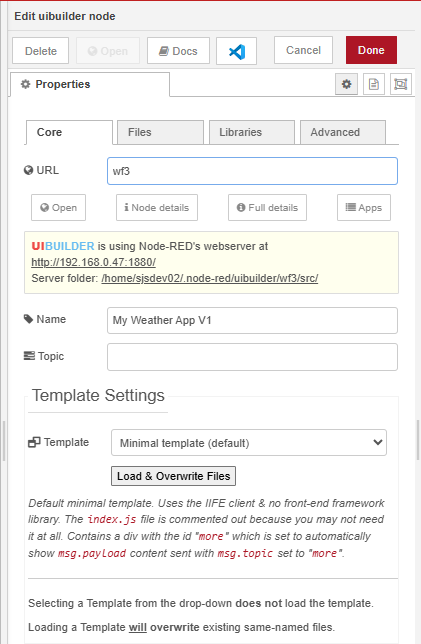

If that doesn't work, I need the output of node-red's log after startup a little further than you've shared, as previously asked. There is a secton in the log that should look something like this:
And I would also need you to make sure that you have something valid in the src folder that you see listed as the "Server folder" on the Core tab of the uibuilder node's configuration panel.

Then, I take care of the screenshot I gave you here above (logs at N-R startup). It didn’t mention the information you request to me because the logs itself stop appear at this line. So the information about uibuilder never appear. It’s like this at each start of N-R. So, for me, it confirm a more general problem.
Due to that situation, I will make a new clean installation on this Dev. Raspberry Pi 5. I believe that’s the best way. This last 4.1 upgarde is maybe the last step of many other small mistakes.
