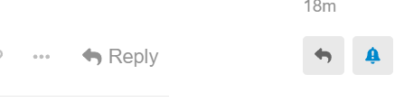

why are there 2 reply-buttons ? 1 individual reply and 1 to everyone ?
The one by the post indicates that you are replying to a particular post. The one at the bottom is for if you want to add a comment but it is not a reply to a particular post.
