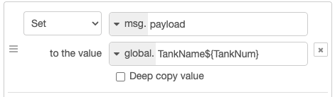

I’m trying to utilize a group environment variable as an addendum to variable names throughout a flow. Attached is a simplified version - a group env variable is set to TankNum = T1 and in theory a change node could set a variable name with a combination of a static name + a variable name. The resulting variable name would be TankNameT1. Is there any way of doing this as this method doesn’t seem to work?

Screenshot 2025-09-01 at 2.01.23 PM
In the change node add a rule before global rule.
set msg. TankNum
to value
$ TankNum
Then in the global rule
use
TankName[msg.TankNum]
Thanks for the assist. It’s currently showing me “undefined” on the debug. New code export and image attached.

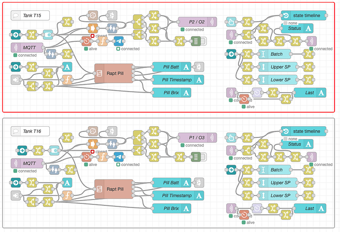

I have about 15 or so tanks that are being temperature controlled - each one in a flow like the flows below. I’m trying to set a group environment variable that can be used to modify some of the variable names so that when I tweak one of these group flows in the future, it will be a lot easier to replicate to each tank.
Your flow creates the following in context data but my version doesn’t create a variable called global.TankNameT1 as I would expect.
Screenshot 2025-09-01 at 3.13.57 PM
So, for example, any time TankC1 is referenced in the name of different variables, the environment variable can be set on a group level and used in different variable names within that group.
