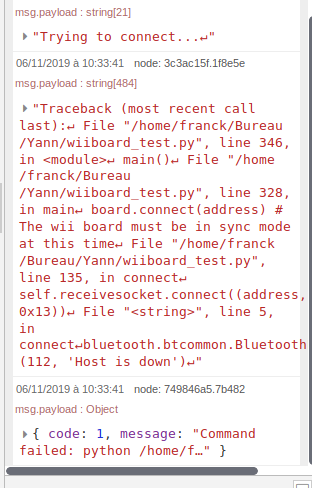

but I got an error in the 3 outputs...
Capture%20du%202019-11-06%2010-47-03
I have not idea why it is not working since it worked in my terminal...

It says "Host is down" near the end! Looks like the Python script it throwing an error.
Also you have appended the msg.payload, does that contain valid parameters?
Yes, I think the python script throw an error but I do not get why since when I run my code inside the terminal it works perfectly... the error "Trying to connect..." comes from my python code..
