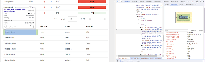

  3. Styling: let me check if I understand this correctly: if I add a Class name on the node propery screen that class name will be added to each class definition within that template node and I can than create override classes to set my own style. For example if I want a table which does not have lines between the lines, I can override the bottom border.
    When I look a the dev tools I see this:

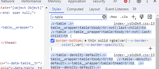

    The cells have a border-bottom-width, border-bottom-style, border-bottom-color that I can override. I did not find any border definition for the table row, only for the cells:
    And the class is this: .v-table__wrapper>table>tbody>tr:not(:last-child)>td. So if my class on the properties screen is set to nolines, I need to create a new style definition like:
.nolines .v-table__wrapper>table>tbody>tr:not(:last-child)>td {
    border-bottom: none;
Is my thought process correct? Is this how you find out what class to define?

No. Adding a class name to the template edit pane adds the class name to the container. You can use it as a selector to target items inside e.g. .myclass > div > span for example.
But since you are using a template this is less necessary, you can simply add classes to the elements in your template html wherever you please.
