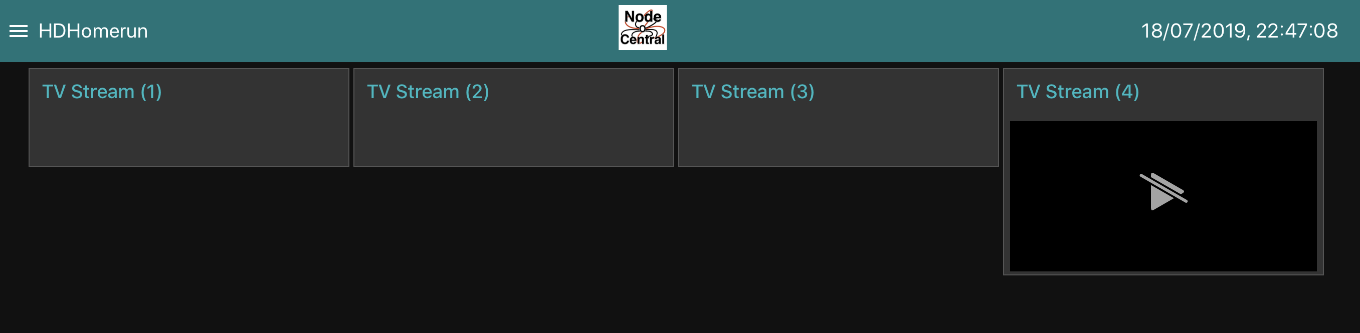

As this is for use on iOS (via an iPad) my options are limited.

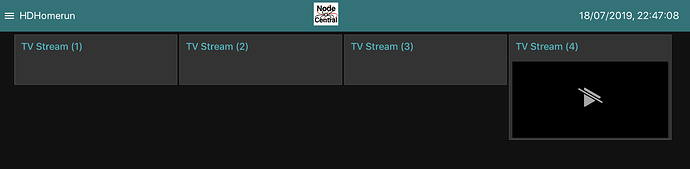

I do however feel like I may have made a little progress, looking here ..
https://developer.apple.com/library/archive/documentation/AudioVideo/Conceptual/Using_HTML5_Audio_Video/Introduction/Introduction.html
Using this..
<video src="http://example.com/path/mymovie.mp4" controls></video>
Which returns this (when used for the 4th stream’s UI widgets) - does this help matters ?

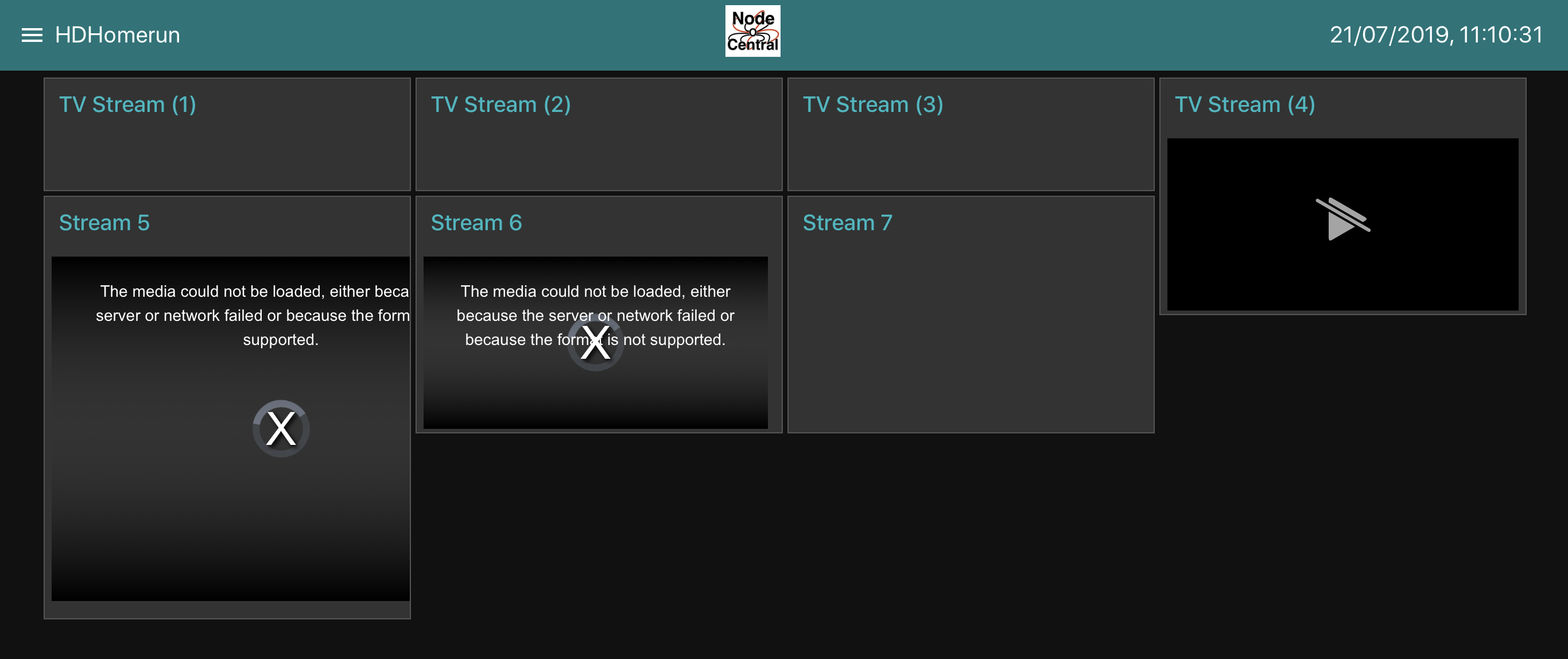

I’m continuing to try to get video streams via the Dashboard UI, the supported video capability of the iOS Safari browser does indeed seem to be my biggest limitation in my preferred design, (no video stream are playing yet) - but i’ll keep plugging away :slight_smile:

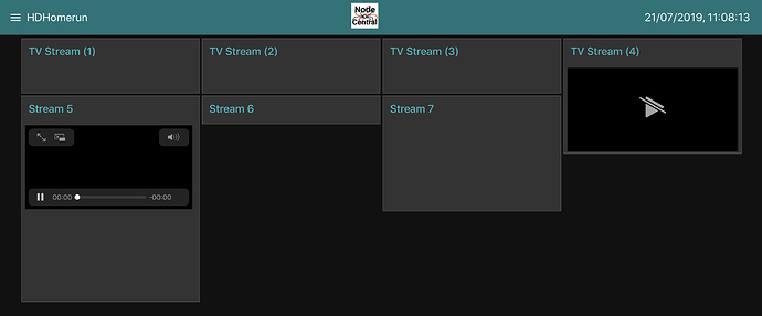

Route (stream 5) showed some promise.. https://videojs.com/getting-started/
Ok, this looks very promising.

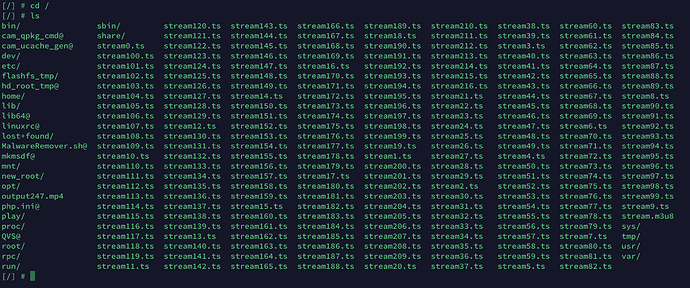

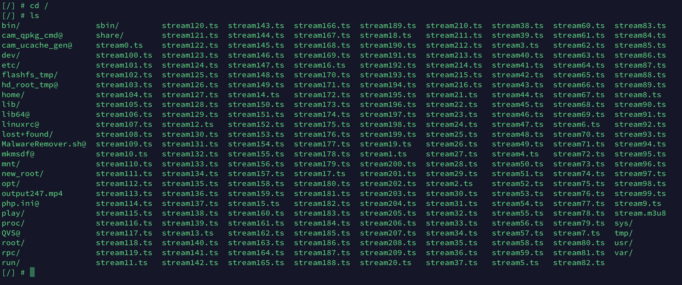

Resulting files on the server..

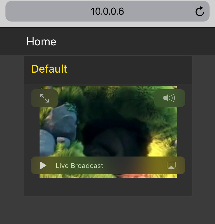

Realtime streaming on iOS.
This assumes you have ffmpeg installed on the machine running node-red.
The flow:
[{"id":"665b41b9.be3548","type":"inject","z":"8a26c31b.4b3b38","name":"stream","topic":"","payload":"","payloadType":"date","repeat":"","crontab":"","once":false,"onceDelay":0.1,"x":200,"y":525,"wires":[["6b0a87ce.c579d"]]},{"id":"6b0a87ce.c579d","type":"function","z":"8a26c31b.4b3b38","name":"","func":"m = msg.payload \nif (m ==='kill'){\n    return {kill:true}\n}\nelse{\nmsg.payload = `ffmpeg -fflags nobuffer \\\n-rtsp_transport tcp \\\n -i \"rtsp://wowzaec2demo.streamlock.net/vod/mp4:BigBuckBunny_115k.mov\" \\\n -async 1 \\\n -copyts \\\n -acodec libmp3lame \\\n-ar 44100 \\\n-ac 2 \\\n -vcodec libx264 \\\n -profile:v baseline \\\n -preset:v superfast\\\n -movflags frag_keyframe+empty_moov \\\n -an \\\n -hls_flags delete_segments+append_list \\\n -f segment \\\n -segment_list_flags live \\\n -segment_format mpegts \\\n -segment_list /home/administrator/.node-red/stream/index.m3u8 \\\n -segment_list_type m3u8 \\\n /home/administrator/.node-red/stream/%d.ts`\n \n  return msg\n}\n","outputs":1,"noerr":0,"x":375,"y":550,"wires":[["838014a2.2b358"]]},{"id":"838014a2.2b358","type":"exec","z":"8a26c31b.4b3b38","command":"","addpay":true,"append":"","useSpawn":"true","timer":"","oldrc":false,"name":"","x":525,"y":550,"wires":[["8078bcc1.0e734"],["d71455f0.a59c38"],["13887079.10e7c"]]},{"id":"8078bcc1.0e734","type":"debug","z":"8a26c31b.4b3b38","name":"","active":true,"tosidebar":true,"console":false,"tostatus":false,"complete":"true","targetType":"full","x":700,"y":500,"wires":[]},{"id":"d71455f0.a59c38","type":"debug","z":"8a26c31b.4b3b38","name":"","active":true,"tosidebar":true,"console":false,"tostatus":false,"complete":"true","targetType":"full","x":700,"y":550,"wires":[]},{"id":"13887079.10e7c","type":"debug","z":"8a26c31b.4b3b38","name":"","active":true,"tosidebar":true,"console":false,"tostatus":false,"complete":"true","targetType":"full","x":700,"y":600,"wires":[]},{"id":"1be68620.5f0482","type":"inject","z":"8a26c31b.4b3b38","name":"kill","topic":"","payload":"kill","payloadType":"str","repeat":"","crontab":"","once":false,"onceDelay":0.1,"x":200,"y":600,"wires":[["6b0a87ce.c579d"]]},{"id":"25dd9106.f7e8fe","type":"ui_template","z":"8a26c31b.4b3b38","group":"bd835a7f.a3cb1","name":"","order":0,"width":0,"height":0,"format":"<video id=\"video-player\" controls preload=\"none\">\n    <source src=\"http://10.0.0.6:1880/index.m3u8\" type=\"application/x-mpegURL\">\n</video>","storeOutMessages":true,"fwdInMessages":true,"templateScope":"local","x":410,"y":450,"wires":[[]]},{"id":"bd835a7f.a3cb1","type":"ui_group","z":"","name":"Default","tab":"6f70ef77.c1505","disp":true,"width":"6","collapse":false},{"id":"6f70ef77.c1505","type":"ui_tab","z":"","name":"Home","icon":"dashboard","disabled":false,"hidden":false}]
There are a couple of things that require some changes to make this work:
  1. The function node contains paths, you will need to change those to your own.
  2. In the node-red settings.js file you need to configure httpStatic to match the path used in the function node
  3. In the template node, change the url (ip-address/path) to your own matching the httpStatic path
This example uses bigbuckbunny, for your stream, remove -rtsp_transport tcp \ and change the rtsp://xx to your own http://zz/xx
No we don’t !!! :crazy_face::partying_face::scream::sunglasses:
Thanks so much @bakman2
