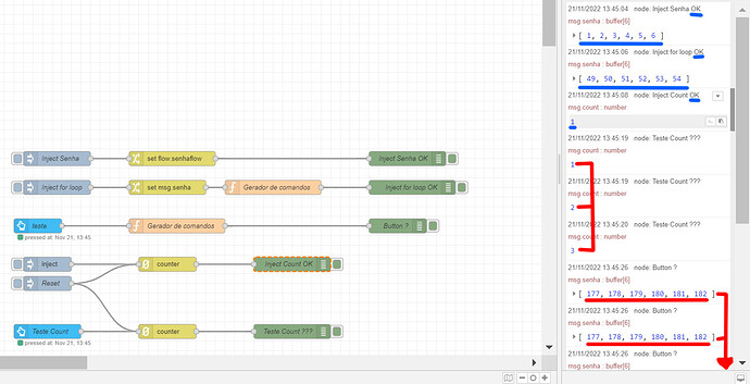

I'm testing some functions and using the inject option works as expected, but I need to use buttons and the behavior is strange.
When using buttons the messages are repeated and the result of the function is wrong and the counter adds up several times even with just one click.
Am I missing something?
