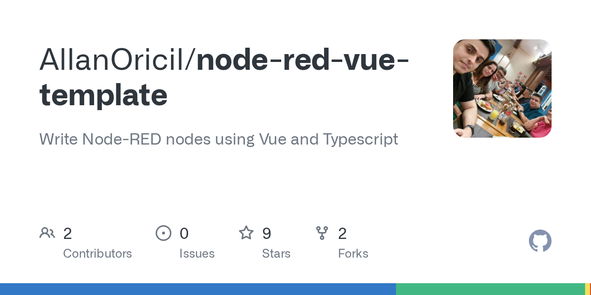

Write nodes using modern tooling
  • It has server side validation for configs and messages using json schemas
  • node forms can be written using vue
And a lot more...
Node-RED core team can adapt my design ideas to the core. I only want the recognition.
@knolleary @dceejay @hardillb
Happy to recognise you, but currently we do not use typescript nor Vue in the core - so are unlikely to pull it in directly. Happy for it to exist as part of the eco-system.
I wanted to make node-red popular among developers making its dx closer to what people are used to nowadays. Also wanted to get recognized in the community for doing something nobody dared to do yet. Im an attention seeker :sweat_smile:
