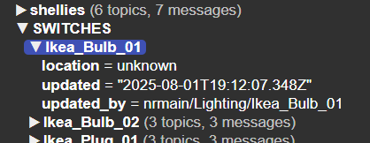

That works where the original message comes direct from a device. It doesn’t always help when the message(s) come from Node-RED. I’m with Paul on this one, I add extra messages, usually to sub-topics, that record the part of my flows (and the NR instance in this case) and the timestamp of the last update.

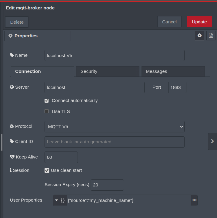

I use the MQTT5 extensions (which mosquitto and node-red support) to add a property to the message indicating the source machine. This has the advantage that it does not change the basic MQTT message (topic and payload), so can be added to existing flows with zero side effects.
To do this all you need to do is to tell node-red that the broker can use MQTT5 and configure the broker like this
Note the user properties at the bottom.
Alternatively you can pass in the source (and any other properties you might want to include, timestamp for example) by passing in msg.userProperties.source with the machine name.
