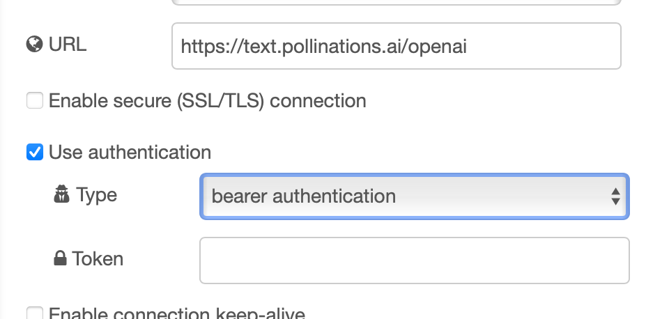

Yeah it was too good to be true where they hit financial limits with everyone abusing their api.
The API token is a bearer token, somewhere in the subflow, there is a http request node, where you can specify the bearer token.
thank you a lot for your quick reply! That works great now again.
