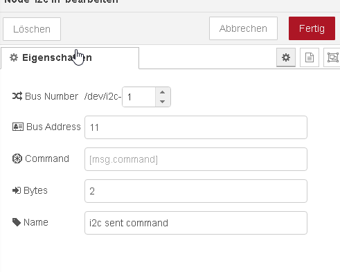

Is the i2c node connected to the RSOC inject node configured properly?
Yes, they all the same:
they get msg.command from the injects
i created an new flow with only one inject and one i2c. but still the same :confused:
