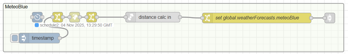

[{"id":"62a1f121315aad32","type":"group","z":"d915a360.b8766","name":"MeteoBlue","style":{"fill":"#e3f3d3","fill-opacity":"0.21","label":true,"color":"#000000"},"nodes":["f0689e110956c737","a12a0bb63b07813c","41d6c8b36ca47933","eb022b60d3a4223c","8f49c26d577a1824","c9a4efa468c8e96a","309f89edbf01a924","bfbd5e7e075f02d3"],"x":54.888885498046875,"y":979,"w":1002,"h":144.4444580078125},{"id":"f0689e110956c737","type":"cronplus","z":"d915a360.b8766","g":"62a1f121315aad32","name":"Every hour 10 seconds before the hour","outputField":"payload","timeZone":"Europe/London","storeName":"","commandResponseMsgOutput":"output1","defaultLocation":"","defaultLocationType":"default","outputs":1,"options":[{"name":"schedule2","topic":"hourlyOWM-day","payloadType":"default","payload":"","expressionType":"cron","expression":"50 59,29 6-23 * * *","location":"","offset":"0","solarType":"all","solarEvents":"sunrise,sunset"},{"name":"schedule3","topic":"hourlyOWM-night","payloadType":"default","payload":"","expressionType":"cron","expression":"50 59,29 0-2 * * *","location":"","offset":"0","solarType":"all","solarEvents":"sunrise,sunset"}],"x":155,"y":1020,"wires":[[]],"l":false},{"id":"a12a0bb63b07813c","type":"change","z":"d915a360.b8766","g":"62a1f121315aad32","name":"","rules":[{"t":"set","p":"payload","pt":"msg","to":"(\t   $apis := $globalContext(\"weather_apis\", \"file\");\t   \t   {\t      \"apikey\": $apis.keys.meteoblue,\t      \"lat\": $apis.lat,\t      \"lon\": $apis.lon,\t      \"asl\": $apis.alt,\t      \"format\": \"json\",\t      \"windspeed\": \"mph\"\t   }\t)","tot":"jsonata"},{"t":"set","p":"url","pt":"msg","to":"https://my.meteoblue.com/packages/basic-1h_basic-day_current_clouds-1h_clouds-day","tot":"str"},{"t":"set","p":"headers","pt":"msg","to":"{\"content-type\":\"application/json\",\"Accept\":\"application/json\",\"User-Agent\":\"node-red\"}","tot":"json"},{"t":"set","p":"distance","pt":"msg","to":"(\t    $apis := $globalContext(\"weather_apis\", \"file\");\t\t    {\t        \"from\": {\t            \"lat\": $apis.lat,\t            \"lon\": $apis.lon\t        },\t        \"to\": {\t            \"lat\": \"n/a\",\t            \"lon\": \"n/a\"\t        },\t        \"units\": \"m\",\t        \"howFar\": \"n/a\"\t    } \t)","tot":"jsonata"}],"action":"","property":"","from":"","to":"","reg":false,"x":215,"y":1020,"wires":[["41d6c8b36ca47933"]],"l":false},{"id":"41d6c8b36ca47933","type":"http request","z":"d915a360.b8766","g":"62a1f121315aad32","name":"","method":"GET","ret":"obj","paytoqs":"query","url":"","tls":"","persist":false,"proxy":"","insecureHTTPParser":false,"authType":"","senderr":false,"headers":[],"x":265,"y":1020,"wires":[["eb022b60d3a4223c"]],"l":false},{"id":"eb022b60d3a4223c","type":"change","z":"d915a360.b8766","g":"62a1f121315aad32","name":"Set to lat/lon for distance calc","rules":[{"t":"set","p":"distance.to.lat","pt":"msg","to":"payload.metadata.latitude","tot":"msg"},{"t":"set","p":"distance.to.lon","pt":"msg","to":"payload.metadata.longitude","tot":"msg"}],"action":"","property":"","from":"","to":"","reg":false,"x":315,"y":1020,"wires":[["8f49c26d577a1824"]],"l":false},{"id":"8f49c26d577a1824","type":"link call","z":"d915a360.b8766","g":"62a1f121315aad32","name":"","links":["8de8d5547f88456d"],"linkType":"static","timeout":"1","x":495,"y":1020,"wires":[["c9a4efa468c8e96a"]]},{"id":"c9a4efa468c8e96a","type":"change","z":"d915a360.b8766","g":"62a1f121315aad32","name":"set global.weatherForecasts.meteoBlue","rules":[{"t":"set","p":"#:(file)::weatherForecasts.meteoBlue","pt":"global","to":"payload","tot":"msg"},{"t":"set","p":"#:(file)::weatherForecasts.meteoBlue.lastUpdate","pt":"global","to":"","tot":"date"},{"t":"move","p":"distance","pt":"msg","to":"payload.distance","tot":"msg"},{"t":"set","p":"weatherForecasts.meteoBlue.distance","pt":"global","to":"payload.distance","tot":"msg"}],"action":"","property":"","from":"","to":"","reg":false,"x":800.8888854980469,"y":1022.4444580078125,"wires":[["309f89edbf01a924"]]},{"id":"309f89edbf01a924","type":"link out","z":"d915a360.b8766","g":"62a1f121315aad32","name":"Out to home dashboard weather route","mode":"link","links":["91681904dca2a264"],"x":1015.8888854980469,"y":1022.4444580078125,"wires":[]},{"id":"bfbd5e7e075f02d3","type":"inject","z":"d915a360.b8766","g":"62a1f121315aad32","name":"","props":[{"p":"payload"},{"p":"topic","vt":"str"}],"repeat":"","crontab":"","once":false,"onceDelay":0.1,"topic":"","payload":"","payloadType":"date","x":160.88888549804688,"y":1082.4444580078125,"wires":[["a12a0bb63b07813c"]]},{"id":"b0eb42bf8e26edf5","type":"global-config","env":[],"modules":{"node-red-contrib-cron-plus":"2.2.4"}}]
Note that you need a retained global context variable called weather_apis that contains your home location and the api keys:
The flow saves everything to another retained context variable and sends it to a UIBUILDER front end.
The front end is rather simplistic right now. When my eyesight is back to normal, it will get improved.
Oh, there is also a distance calculation that I use with any weather API call. It works out the distance from the returned weather data location to my home location. This is because some API's take data from nowhere near where you are and this can make a massive difference in some cases like mine where even a few 100 metres away can have different weather conditions due to the steep hills and location of Sheffield.
