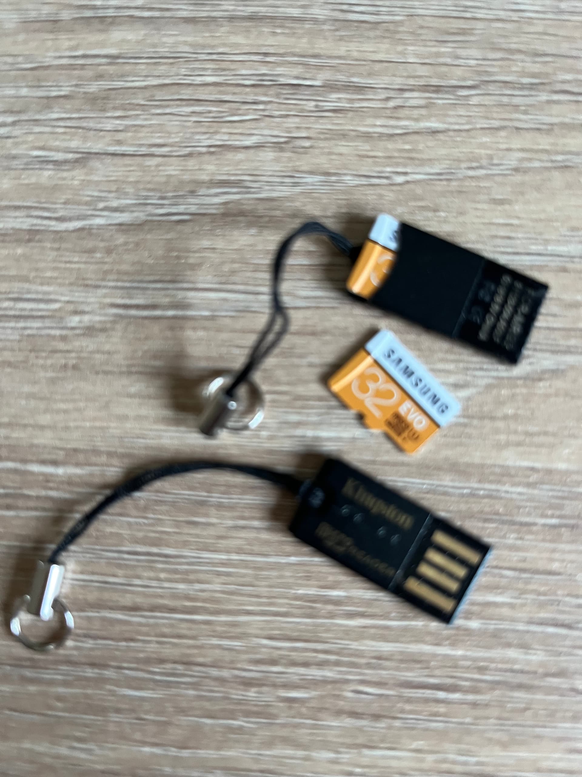

Just wanted to share a finding I should have found years ago. Since long I have a personal habit of making a copy of my SD Cards in all my RPi's from time to time. In all of them I have an additional SD Card reader with an extra SD Card of similar size as the active one

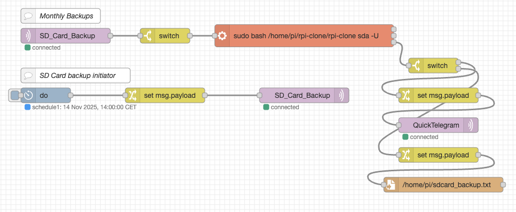

Next up was to setup some scheduled unattended automation. No doubt, I thought let's use Node-RED to make this happen. In all RPi's I added a simple flow that would run the tool when triggered via MQTT. If it would fail for some reason, I will get notified via Telegram. If successful, just a positive log entry will be added in a simple text file
In one of the computers I also added the triggering part, initiating the backup in all my RPi's once per month. After my next test with all running and finishing successfully, I could not hesitate, I added my Jetson Orin Nano to the group EDIT: but that device was not supported
