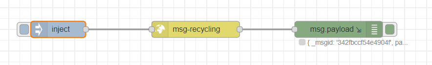

I'm experimenting trying to learn how to create nodes with installing them locally with npm install on the package.json file.
For learning purposes & experimentation, I have very generic node called msg-recycler where at the moment I am just feeding some string data into it attempting to validate the data and return Boolean True or False on the node output for the message.topic.

Basically its validating the word in the string read (requestType) and analogInput (pointType) in the string "read 12345:2 analogInput 1" in the validate function, hopefully that makes sense. I am trying return Boolean in the Node msg.payload = valid; //Boolean
In the debug I get this returned, circular dependancy issue. Would anyone have any tips to try?
