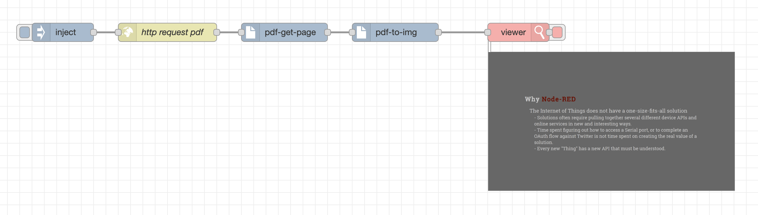

I updated the library a bit. Added an example, it is available via pallette.
New node - pdf page to image.
Display page in flow - need node-red-contrib-image-tools -> viewer
