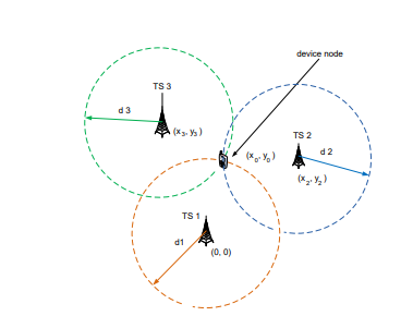

I have a mathematical calculation I needed solved, to do with the intersection of spheres.
I have a node transmitting a message and it is received by 3 or more gateways (base stations). The location of the node is unknown and I want to calculate it.
The gateway location and the timestamp the message arrives is known.
The location is in the msg.payload.uplink_message.rx_metadata[i].location.latitude and msg. payload.uplink_message.rx_metadata[i].location.longitude
Time stamp is msg. payload.uplink_message.rx_metadata[i].time
Here I am showing an example of 3 gateways, but it could be a lot more, 4 gateways will give 3D accuracy.

It helps to know the name of the tool your trying to use. This is a trilateration problem. Old school single engine pilots do the opposite of this with old AM radio towers to figure out where we are at. Heck only need 1 tower because as we move towards it we can plot 2 points over time.
Your example only gives one tower. Be helpful to have 3
Ill take a stab at it next weekend if no one else touches it..... I do like my Maths.
Question: does the node move around or is it stationary ? if it moves you only need one tower to pull off a ruff estimate of its location +/- the opposite side of the radius. 2 towers fixes that for a moving node.
Factors that mess up the equation. If the tower(s) is/are on hill(s) at high elevations and the node is low to the ground then your estimation of location err goes up. or you need 3 towers for sure!

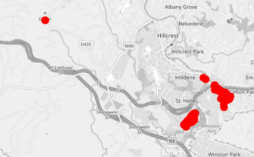

I am using currently a call to a API, but some how the error gets worse when they have more than 3 points and they don't exclude 2 point calculations.
This is a stationery node over the last 24 hours.
