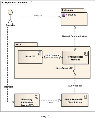

I am working to connect a device that can only be accessed through a remoteAPI via a WCF channel. The way we are doing it is to produce an external piece of code that can make it function as a basic REST API, then we connect it to Node-RED:
Is there anything that can handle this using only Node-RED?

Just for completeness, here is the basics from a chat-GPT attempt at making it work direct from Node-RED:
TL:DR, It is a custom API so can't do it.

1.2 The actual Nova Remote API endpoints :bullseye:
This is the gold:
<client>
  <!-- Endpoints for Nova remote API. -->
  <endpoint
    name="LocalNovaConnection"
    address="net.pipe://localhost/Infratec/remoteAPI"
    binding="customBinding"
    bindingConfiguration="longSendNamedPipeBinding"
    contract="FOSS.Nova.CoreServer.RemoteAPI.Client.Contract.INovaRemoteAPI"/>
  <endpoint
    name="RemoteNovaConnection"
    address="net.tcp://localhost:8899/Nova/remoteAPI"
    bindingConfiguration="longSendTcpBinding"
</client>
So we now know:
  • Service contract:
    (this is the WCF interface your .NET proxy uses)
  • Local endpoint (on same PC only):
    LocalNovaConnection →
    Binding: customBinding/longSendNamedPipeBinding
  • Remote endpoint (TCP, potentially from another machine):
    RemoteNovaConnection →
    Binding: customBinding/longSendTcpBinding
If another PC connects over the LAN, its address would look like:
net.tcp://<NovaPCNameOrIP>:8899/Nova/remoteAPI
1.3 No HTTP / SOAP endpoint
Important: there is no basicHttpBinding, wsHttpBinding, .svc URL, or http://... endpoint defined here.
Everything is:
  • net.pipe://... (Named Pipes, local only)
  • net.tcp://... with WCF customBinding (binary)
That matches the Remote API manual: they expect clients to use their .NET proxy and WCF, not generic HTTP/SOAP.
2. What this means for Node-RED (hard truth + good workaround)
You originally asked for:
“code that i can use in Node-RED using either HTTP, Websocket, TCP, or UDP, to connect to WCF”.
Given what we now know:
  • The Nova Remote API uses net.tcp + customBinding + binaryMessageEncoding.
  • Node-RED’s tcp node can only send/receive raw bytes; it does not understand WCF’s binary framing, channel handshakes, message headers, duplex callbacks, etc.
  • There is no HTTP/SOAP endpoint we can just point a SOAP node at.
  • WebSocket and UDP are not used for the actual Remote API calls (UDP is only used for discovery in the .NET library).
So:
:cross_mark: Direct Node-RED → Nova Remote API is not feasible
You cannot realistically point Node-RED straight at:
and expect it to work. You’d have to re-implement the WCF protocol in JavaScript, including duplex callbacks, addressing headers, etc. That’s insane-level work and very brittle.
