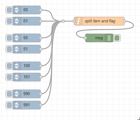

Here is a mock up of how I might handle this - may be of use?
chrome_xrnAFCn0TJ
[{"id":"1b0d37fb2471123d","type":"inject","z":"b1993d2a213b2bb0","name":"","props":[{"p":"payload"},{"p":"topic","vt":"str"}],"repeat":"","crontab":"","once":false,"onceDelay":0.1,"topic":"","payload":"00","payloadType":"str","x":1510,"y":1020,"wires":[["d7b3f0f7e6adb49e"]]},{"id":"d7b3f0f7e6adb49e","type":"junction","z":"b1993d2a213b2bb0","x":1640,"y":1060,"wires":[["d6823181f9c5a68c"]]},{"id":"11958afbcbb212b3","type":"inject","z":"b1993d2a213b2bb0","name":"","props":[{"p":"payload"},{"p":"topic","vt":"str"}],"repeat":"","crontab":"","once":false,"onceDelay":0.1,"topic":"","payload":"101","payloadType":"str","x":1510,"y":1260,"wires":[["d7b3f0f7e6adb49e"]]},{"id":"4f746604fc72f5ee","type":"inject","z":"b1993d2a213b2bb0","name":"","props":[{"p":"payload"},{"p":"topic","vt":"str"}],"repeat":"","crontab":"","once":false,"onceDelay":0.1,"topic":"","payload":"100","payloadType":"str","x":1510,"y":1220,"wires":[["d7b3f0f7e6adb49e"]]},{"id":"000c164834baf795","type":"inject","z":"b1993d2a213b2bb0","name":"","props":[{"p":"payload"},{"p":"topic","vt":"str"}],"repeat":"","crontab":"","once":false,"onceDelay":0.1,"topic":"","payload":"01","payloadType":"str","x":1510,"y":1060,"wires":[["d7b3f0f7e6adb49e"]]},{"id":"9c4c4cf31f1c799f","type":"inject","z":"b1993d2a213b2bb0","name":"","props":[{"p":"payload"},{"p":"topic","vt":"str"}],"repeat":"","crontab":"","once":false,"onceDelay":0.1,"topic":"","payload":"50","payloadType":"str","x":1510,"y":1120,"wires":[["d7b3f0f7e6adb49e"]]},{"id":"47e5392a2d4704e8","type":"inject","z":"b1993d2a213b2bb0","name":"","props":[{"p":"payload"},{"p":"topic","vt":"str"}],"repeat":"","crontab":"","once":false,"onceDelay":0.1,"topic":"","payload":"51","payloadType":"str","x":1510,"y":1160,"wires":[["d7b3f0f7e6adb49e"]]},{"id":"a34440712cb2d85b","type":"inject","z":"b1993d2a213b2bb0","name":"","props":[{"p":"payload"},{"p":"topic","vt":"str"}],"repeat":"","crontab":"","once":false,"onceDelay":0.1,"topic":"","payload":"990","payloadType":"str","x":1510,"y":1320,"wires":[["d7b3f0f7e6adb49e"]]},{"id":"290c661b2db3d393","type":"inject","z":"b1993d2a213b2bb0","name":"","props":[{"p":"payload"},{"p":"topic","vt":"str"}],"repeat":"","crontab":"","once":false,"onceDelay":0.1,"topic":"","payload":"991","payloadType":"str","x":1510,"y":1360,"wires":[["d7b3f0f7e6adb49e"]]},{"id":"d6823181f9c5a68c","type":"function","z":"b1993d2a213b2bb0","name":"split item and flag","func":"const parts = msg.payload.split('')\nconst flagLookup = {\n    \"0\": \"triggered\",\n    \"1\": \"reset\",\n}\nmsg.payload = {\n    item: parts.slice(0, -1).join(''),\n    flag: flagLookup[parts.pop()] || 'unknown'\n}\nreturn msg;","outputs":1,"timeout":0,"noerr":0,"initialize":"","finalize":"","libs":[],"x":1770,"y":1060,"wires":[["4fdee4fb2e42921c"]]},{"id":"4fdee4fb2e42921c","type":"debug","z":"b1993d2a213b2bb0","name":"","active":true,"tosidebar":true,"console":false,"tostatus":true,"complete":"true","targetType":"full","statusVal":"payload","statusType":"auto","x":1770,"y":1120,"wires":[]}]

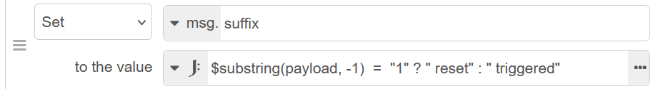

You changed the requirement!
Looking just at the last character I can set msg.suffix to be either " reset" or " triggered" using a ternary expression (<if something> ? <value> : <otherwise>)
And shedding the last character:
I get "Input 1" ... "Input 10"
Concatenating them
[{"id":"0c6c144a4b5511a5","type":"change","z":"8e65d60a7b0b8156","name":"","rules":[{"t":"set","p":"suffix","pt":"msg","to":"$substring(payload, -1)  =  \"1\" ? \" reset\" : \" triggered\"","tot":"jsonata"},{"t":"set","p":"prefix","pt":"msg","to":"\"Input \" & $substring(payload, 0, $length(payload) -1)","tot":"jsonata"},{"t":"set","p":"payload","pt":"msg","to":"prefix & suffix","tot":"jsonata"}],"action":"","property":"","from":"","to":"","reg":false,"x":280,"y":80,"wires":[["3a2f3178a32dd4f3"]]},{"id":"963aa609d3bae5c8","type":"inject","z":"8e65d60a7b0b8156","name":"","props":[{"p":"payload"},{"p":"topic","vt":"str"}],"repeat":"","crontab":"","once":false,"onceDelay":0.1,"topic":"","payload":"10","payloadType":"str","x":110,"y":60,"wires":[["0c6c144a4b5511a5"]]},{"id":"82b48836e0465f64","type":"inject","z":"8e65d60a7b0b8156","name":"","props":[{"p":"payload"},{"p":"topic","vt":"str"}],"repeat":"","crontab":"","once":false,"onceDelay":0.1,"topic":"","payload":"101","payloadType":"str","x":110,"y":100,"wires":[["0c6c144a4b5511a5"]]},{"id":"3a2f3178a32dd4f3","type":"debug","z":"8e65d60a7b0b8156","name":"debug 8","active":true,"tosidebar":true,"console":false,"tostatus":false,"complete":"false","statusVal":"","statusType":"auto","x":460,"y":80,"wires":[]}]
You may be able to combine these into a single line in the change node.
