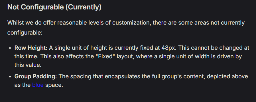

In below image, red line is image container and there gap between group container which is grey line.
reference guideline is Layouts | Node-RED Dashboard 2.0
Have you tried editing your dashboard theme(s) Layouts | Node-RED Dashboard 2.0
I tried but gap inside the group is not confifurable.
