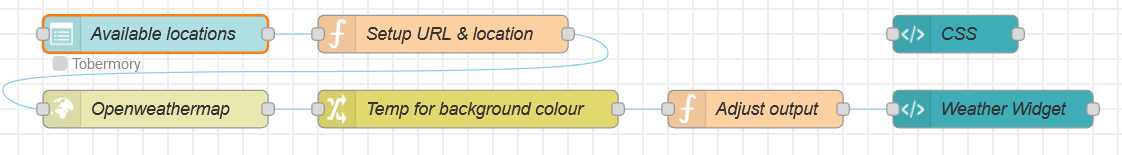

Compact Multi-location Weather Display
This flow fetches weather data for a given location from openweathermap.org (you need a free API key) and crams it into a 9 x 4 unit UI template.
Features:
  • Forecasts are shown hourly for up to 6 hours plus today and the next 4 days.
  • Times (and days - Auckland) are the local time, not UTC
  • The background colour blends from cool blue to warm red according to the "Feels Like" temperature.
  • If there are weather alerts the text is shown and icons change colour for the affected period (Tobermory).
  • Required inputs are Location name, latitude & longitude so it should be possible to pick from a map.
  • Optional inputs are subjective cold and hot according to the location (a Greenlander probably feels hot at a lower temperature than a Sri Lankan). Obviously not so easy to derive from a map.
  • The template is HTML and CSS only.
Issues:
  • It's cramped. Very small text.
  • If both rain and snow amounts are predicted, the snow amount is very cramped (Tobermory).
  • But if neither, there is a noticeable gap below the icons (N'Djamena).
  • Sometimes a weather alert is shown which relates to a day beyond the 5 days shown (Juneau).
  • Weather alerts are in the local language? May cause display issues?
Would be nice?
  • A local time digital clock.
  • "Take an umbrella" notication.
  • UV index.

Hello guys do you have this template modified for Dashboard 2.0. I cannot make it to work with my poor knowledge. Thanks in advance
I started working on it but it's not complete.
If you show us your attempt so far we might be able to fix it between us.
SInce I am not an expert in programming I just copied and pasted the code from dashboard 1 to dashboard 2.0. And of course it did not work. I have no clue of ewhat the differences are sorry
I don't seem to be able to use OWM any more - I generated a new key but I keep getting a 401 response - invalid key.
i can provide you with my apikey temporarly to test if you like.
in anyway it takes some time for the api to get valid. it happened to me too in the past.
I've use it in the past and had 2 other API keys which I also tried. So not sure what's wrong. If you want to pm me your key, I'll just use it for a one-off test.
I intended to create a uibuilder version of this example. :slight_smile:
i just did it.
Are you using the "onecall" api?
A sample msg.url
https://api.openweathermap.org/data/3.0/onecall?lat=101.89&lon=7.12&units=metric&appid=0123456789abcdef01234567890abcdef
I was very proud of this dashboard until my other half told me the colours are ugly :astonished_face:
I think if I was doing it now, I'd try to use a single background colour using HSL color space and varying the hue.
Weird, that worked.
No, I'm using the v2.5 API
This is direct from their API docs (missing the key obviously)
https://api.openweathermap.org/data/2.5/weather?lat=44.34&lon=10.99&appid=
:rofl:
yes. one call api 3.0
No, onecall 3.0 is a different subscription. Also free but you have to sign up separately.
i am just saying i am using api 3.0 not 2.5.
Your URL works with my appid too
