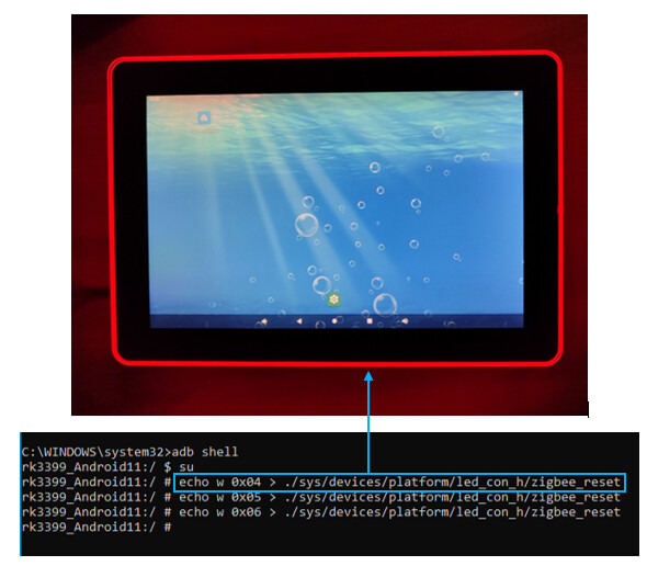

I have android wall with LED Bar, I already to control LED Bar from cmd (adb shell)and working well.
android wall IP : 192.168.16.129
port adb : 55555
  1. Connect android wall send command “adb connect 192.168.16.129:5555”
  2. Send command “adb shell”
  3. Send command “su” Super User
  4. Send command led bar
    Red : “echo w 0x04 > ./sys/devices/platform/led_con_h/zigbee_reset”
    Green : :“echo w 0x05 > ./sys/devices/platform/led_con_h/zigbee_reset”
    Blue : “echo w 0x06 > ./sys/devices/platform/led_con_h/zigbee_reset”
I tried to make it like this can connect
I tried sending a command to turn on the led bar but not working.

I have a android wall mount with LED bar
Change red color I send the command like this
And if change to green color I send it.
This information from factory
