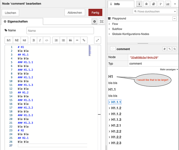

Is it (easily …) possible to set / modify how markdown is rendered in NR?
I use Obsidian and like the bigger font for # Heading level 1 compared to ## Heading level 2
However, I prefer NR’s color for code and the nicer bullets changing w/ indentation.

.red-ui-help h1 {
        font-size: 3em;
Then restart Node-red.
This styles h1 elements within a div with class red-ui-help.
3em; is probably too big. 2 - 2.5em; may be just right.
