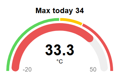

Unfortunately the same change was not applied to the label field. If it had been, you could have set the label using
And the gauge might display something like this, without a preceding change node.
