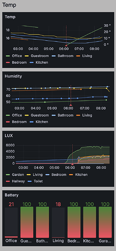

I’m usiing iFrames extensively for my integration of Grafana dashboards without performance issues. All data is written by sensors directly into MSSQL.(Node-Red, Grafana and MSSQL running in Dockers on same machine i5-Gen8 laptop with Ubuntu).
The only thing I had realized was that sometimes there is auto-refresh of the graphs or disappear. After F5 all is good again. I solved it by injecting a refresh command every hour. There was no impact to actual data in the DB .. just the display-refresh.
I have several of below iFrames (~10-15) showing various different Grafana -dashboards. I monitor the CPU-load and Memory usage with Dozzle, and all is stable for last 6 months.
Sorry, I forgot to mention. I used DB2 Chart-Node as well and had Memory/CPU issues, but could never figured out the root-cause. Thats why I did the move to Grafana.
Thanks for sharing, nice graphs.
