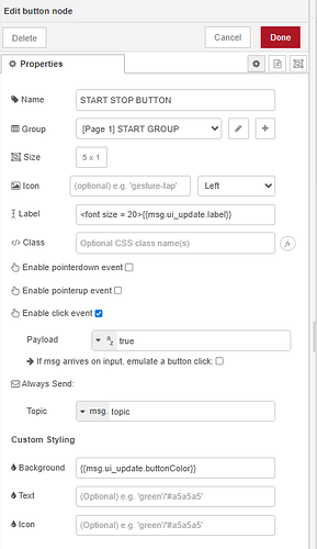

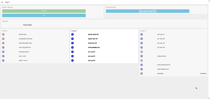

Dashboard 2 buttons "grayed" out?
I'm using dashboard 2, and my widgets here are grayed out.
Is it somehow disabled? Because I can't click on them either.

        "type": "ui-button",
        "z": "e5b4562d25a44875",
        "group": "d48622d0705b8988",
        "name": "START STOP BUTTON",
        "label": "<font size = 20>{{msg.ui_update.Label}}",
        "order": 1,
        "width": "5",
        "height": "1",
        "emulateClick": false,
        "tooltip": "",
        "color": "",
        "bgcolor": "",
        "className": "",
        "icon": "",
        "iconPosition": "left",
        "payload": "true",
        "payloadType": "str",
        "topic": "topic",
        "topicType": "msg",
        "buttonColor": "msg.ui_update.buttonColor",
        "textColor": "",
        "iconColor": "",
        "enableClick": true,
        "enablePointerdown": false,
        "pointerdownPayload": "",
        "pointerdownPayloadType": "str",
        "enablePointerup": false,
        "pointerupPayload": "",
        "pointerupPayloadType": "str",
        "x": 1170,
        "y": 680,
                "a7c4de105333eb1f"

        "id": "36105cff195f13ab",
        "type": "ui-group",
        "name": "Group 3",
        "page": "8b20a6d5d1ae7cd3",
        "width": "4",
        "height": 1,
        "order": 6,
        "showTitle": true,
        "className": "",
        "visible": "true",
        "disabled": true,
        "groupType": "default"
        "id": "d48622d0705b8988",
        "type": "ui-group",
        "name": "START GROUP",
        "width": "6",
        "height": 1,
        "order": 1,
        "showTitle": true,
        "className": "",
        "visible": "true",
        "disabled": true,

I just noticed this
There's an error UI-spacer:spacer at the bottom.
I got to my layout, but I don't see anything about a UI-spacer. How do I find this?
Can you share the flow with your 3 buttons?
SOLVED!
so I had these "locked"
I thought they were to prevent modification/movement of the objects. Upon closer inspection, the mouseover reads DISABLE. I unlocked the icons and it's working now.
