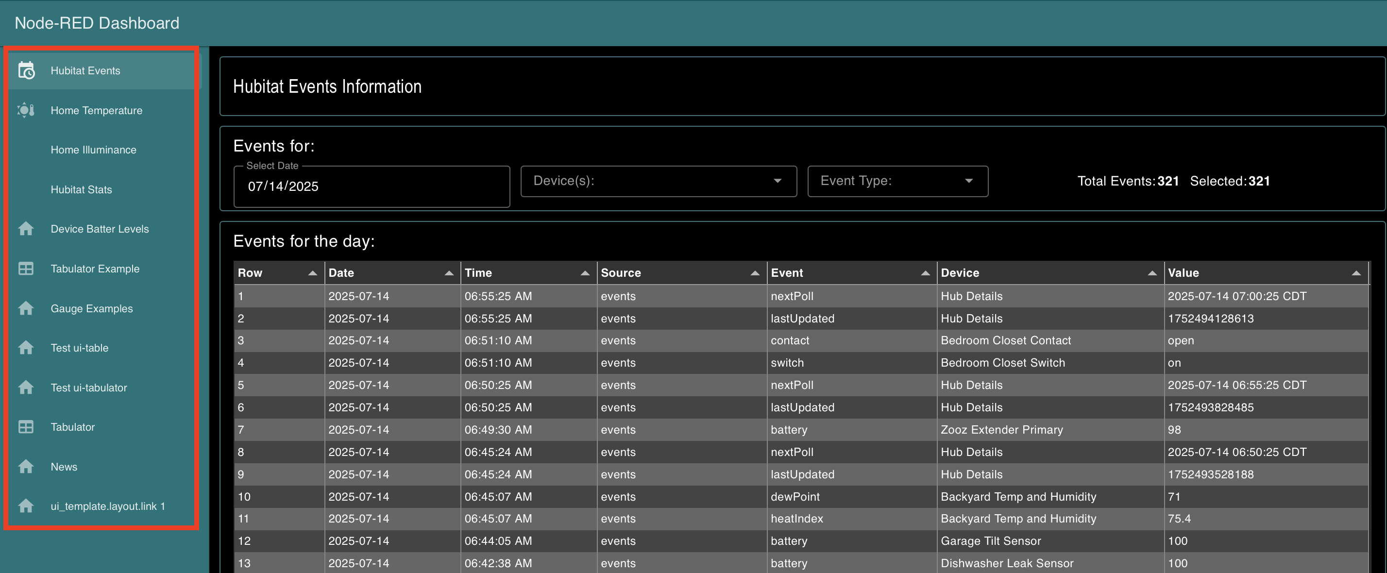

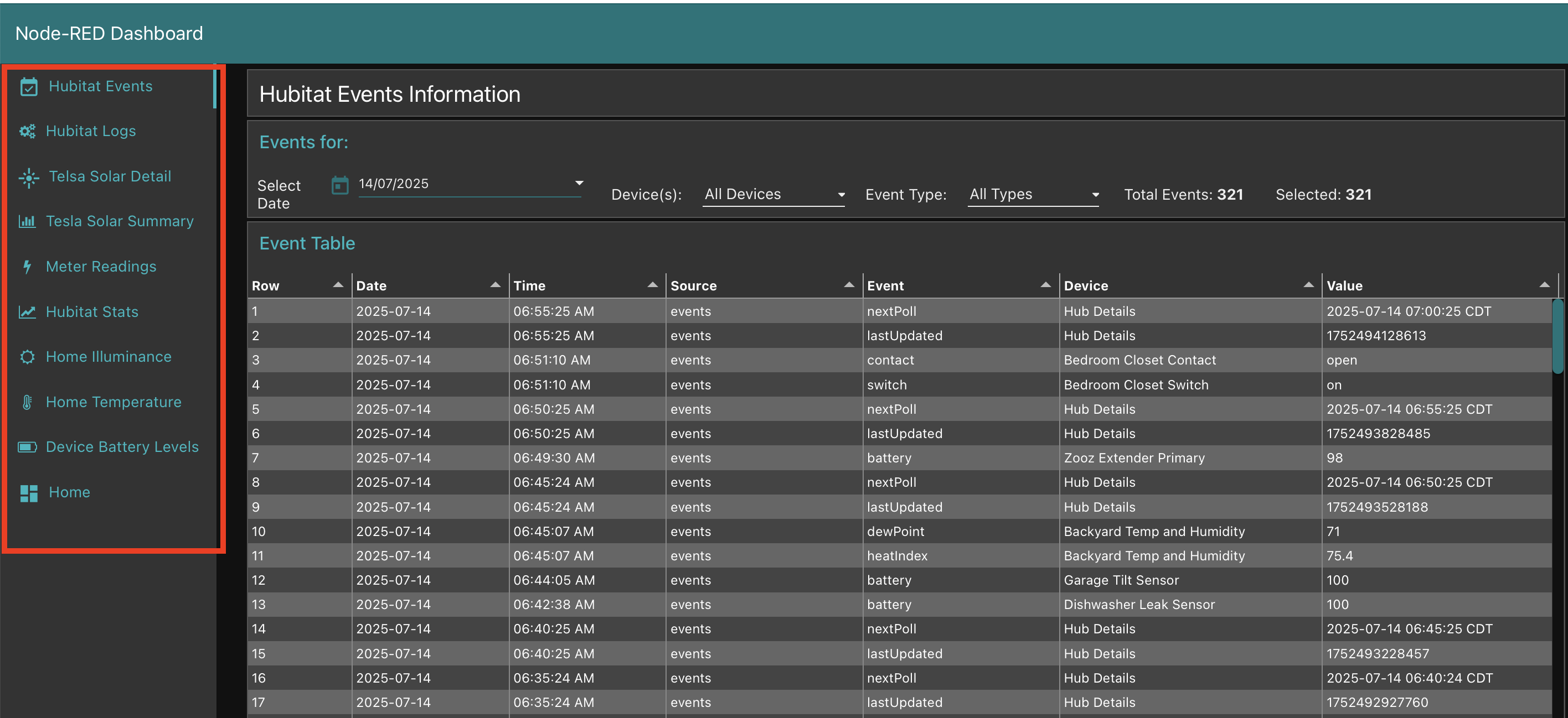

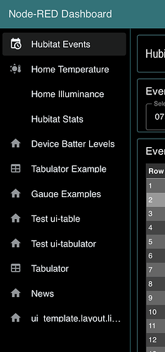

Experimenting with moving from DB1 to DB2. I've gotten one page to work (almost) but I'm trying to figure out how to replicate the "dark" theme from DB1 for the side navigation panel.
DB1 Example:
DB2 Example:

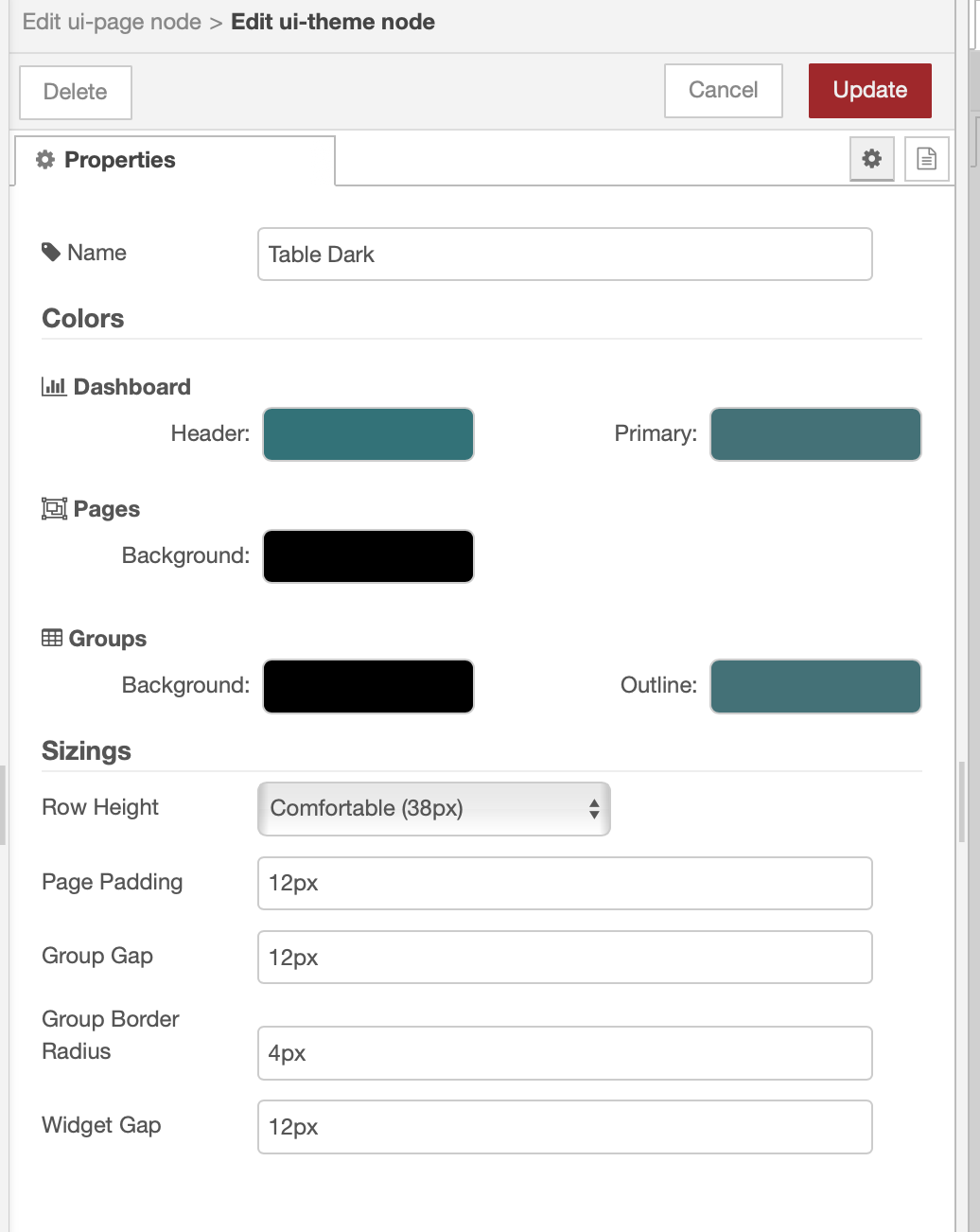

ui-theme node
What I would like to do is have the background color on the navigation panel be black, the text size to be larger (it looks squished).
I don't have any CSS experience to please be gentle. Thanks for your help :folded_hands:t3:
Also, does anyone know why the outline of the text boxes in the DB2 example (date picker - "Select Date" and drop downs - "Devices (All)" and "Event Type") are different sizes?

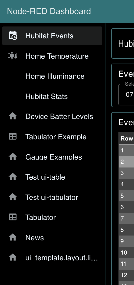

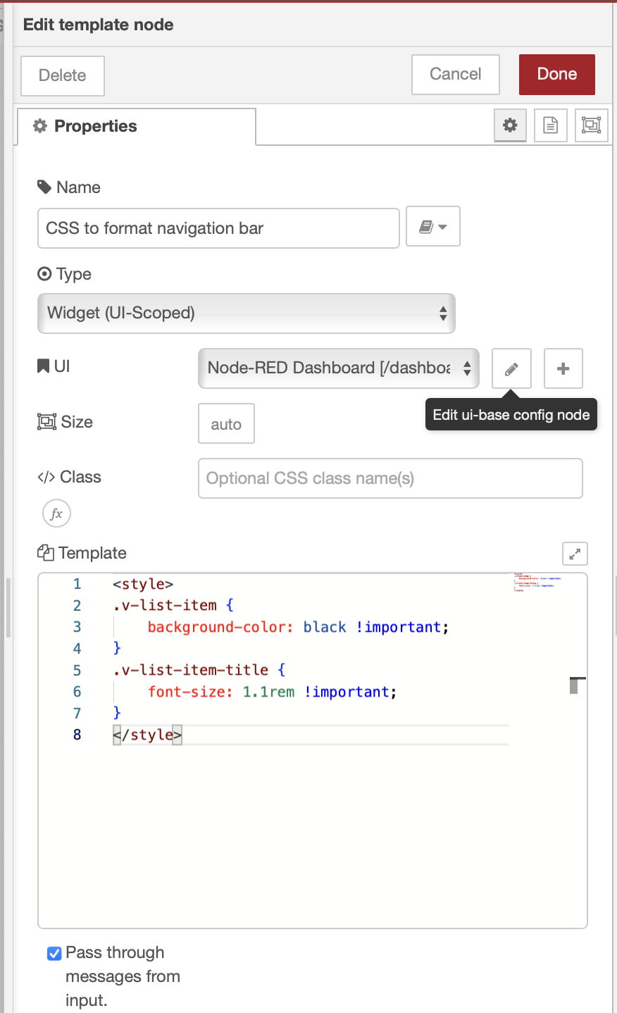

Thanks so much for the quick response. I’m assuming that if I put those in a template node and make the scope “CSS (All Pages)” that will work? Or do I need to do something different?
EDIT: That fixed the colors/size for the list items, but the background for the panel is still "green".
I think I need to be doing something with .v-navigation-drawer but not certain what property I should be setting
Yes ui-template Widget ui-scoped should do the trick
Wrap in <style> </style>
Unfortunately, that did not change the color for the background of the navigation panel (still looks the same as the screenshot I posted above (black background on menu items and text is larger). Below is the configuration of ui-template

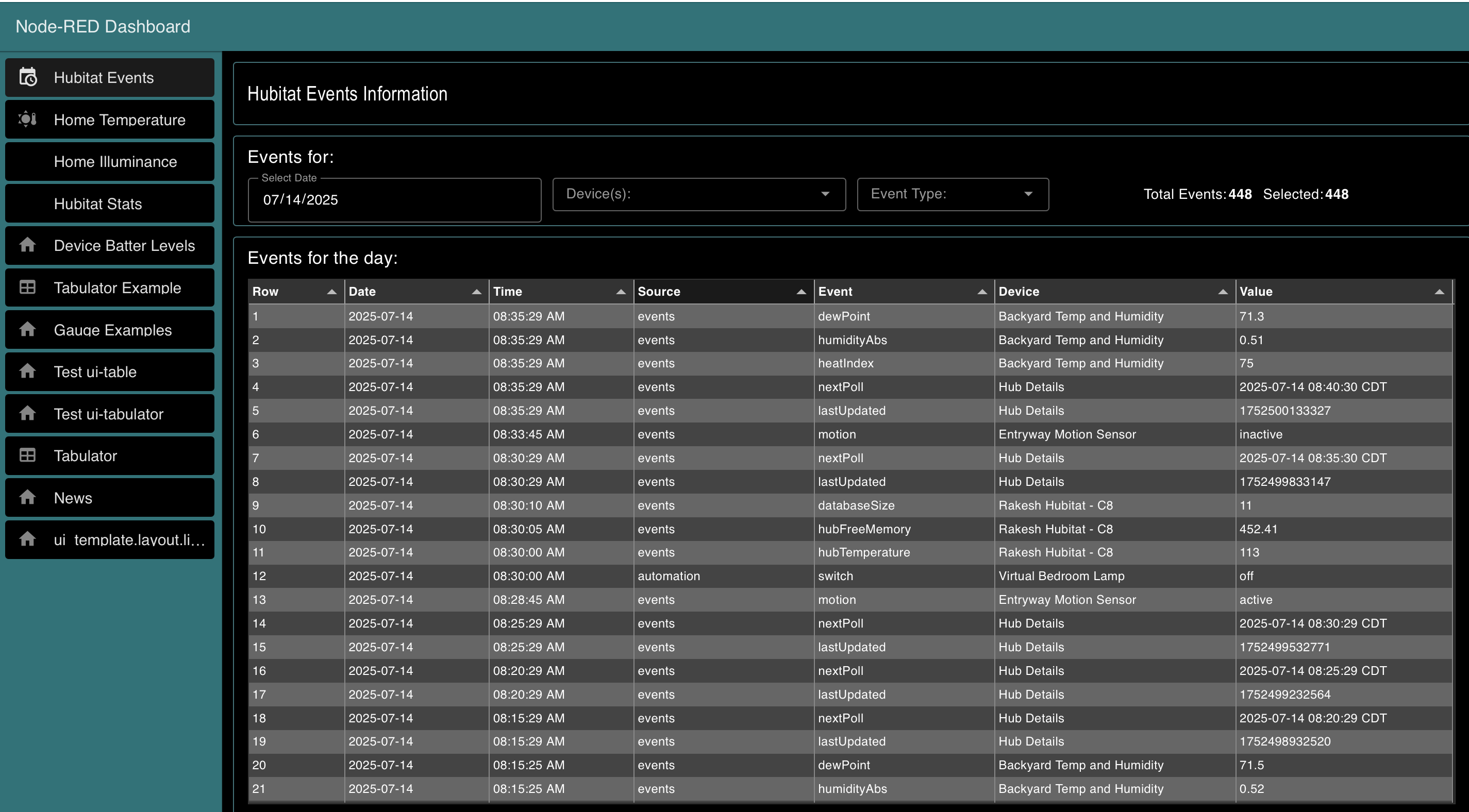

Thanks so much! That did it. I did change it to CSS (All Pages) and removed the "" tags.
This is what it the template node config is now:
.v-list-item {
    background-color: black !important;
.v-list-item-title {
    font-size: 1.1rem !important;
.v-navigation-drawer__content {
background: black;
color: aliceblue;
And this is what it looks like:
@gerrybartley @jbudd - Thanks again for all your help :folded_hands:t3:
