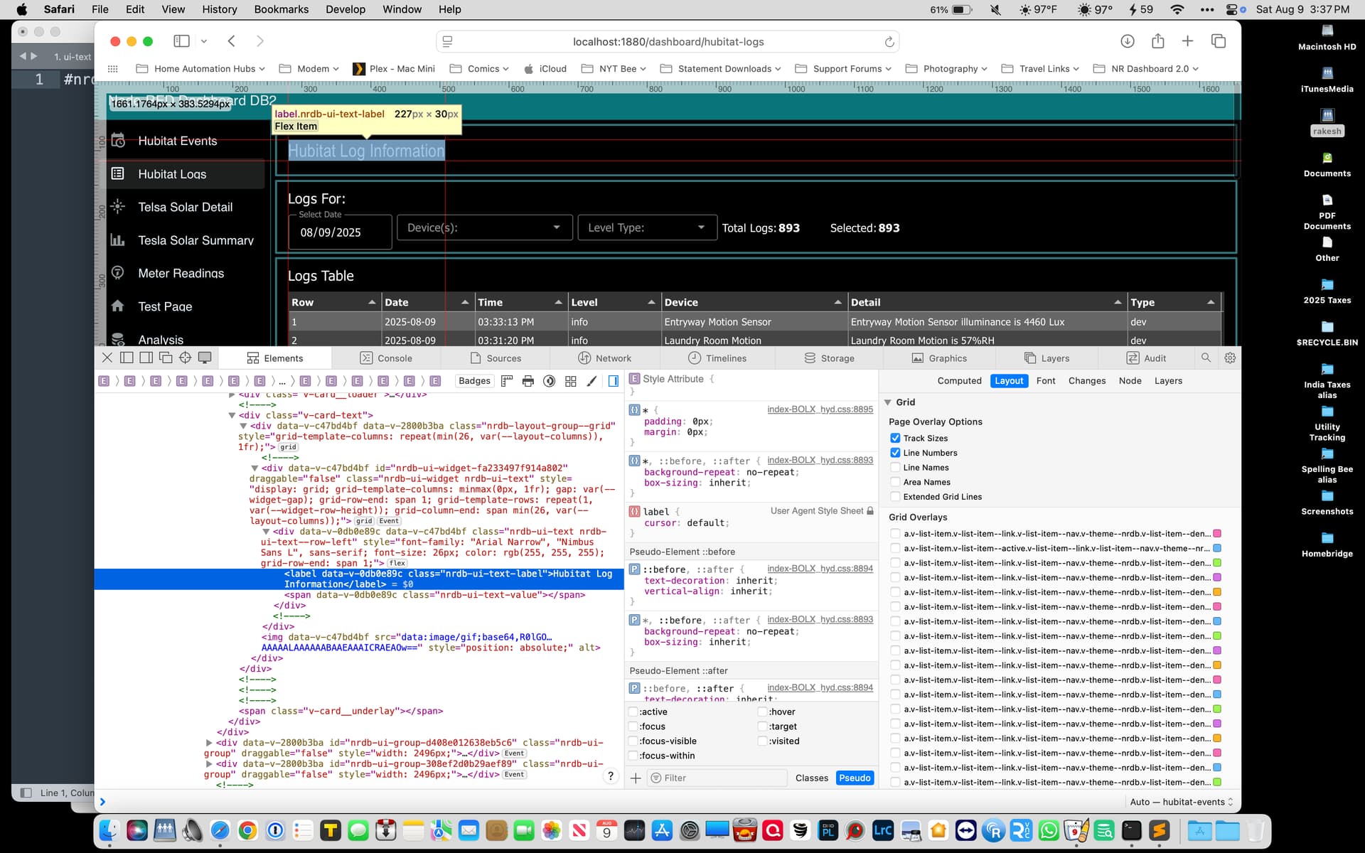

On my dashboard page(s), I have a “title” label in a ui-text node. Currently, I have overridden the font properties (font-family, font-size, color) by using “Apply style” . I am trying to identify the CSS selector to target and then apply a style defined in a CSS ui-template.
Below is a screen shot of the Inspect Element menu item. Is the correct selector “.nrdb-ui-text-label” as shown in the tooltip or is it something else? If so, how do I find it?
Thanks for your help
Screenshot of Dashboard page with Elements
Well yes it is.

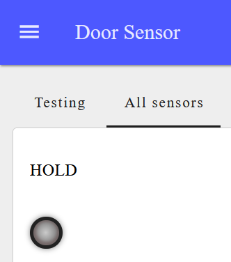

Here is a text widget on my dashboard (the text is "HOLD") without any custom CSS styling.
And here is a CSS template node.
You can see that I set it to apply to a single dashboard page "Door Sensor"
In the template body I got rid of all the default junk because it's not relevant to a CSS template. Notice that not even the <style> and </style> tags are left. You might assume that the dashboard is smart enough to ignore these for a CSS template, but no.
The CSS is this
.nrdb-ui-text-label {
    color: red;
    font-size: 1.5rem;
The dot at the start indicates that we are styling an item with a particular class. If it was an id it would be a # instead #nrdb-ui-text-label
The styles to apply are wrapped between curly brackets, and each one must have a semicolon after it.
After deploying, the dashboard looks like this:
Note that all text widgets on this page will now be red and a larger font size.

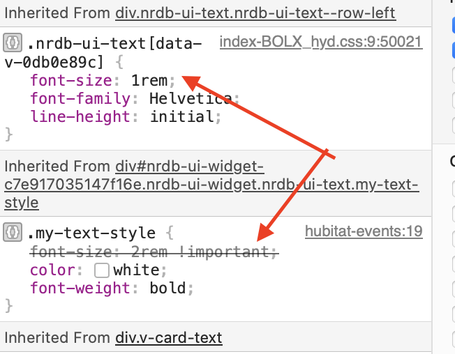

@jbudd - thanks so much. I think I posted an update right when you posted the message above. My updated CSS was similar to yours and what I did was apply it in the “class” property of the widget. It styled the text correctly EXCEPT for the font-size. Adding “!important’ after the font-size did not change it either. It looks like it is being overridden by this (arrow). If I turn off the font-size in the style panel, my CSS works. Any thoughts on how I can work around this?
I do need it to apply to just one ui-text widget on each page.
EDIT: You can see it being ignored here (the 2rem is my custom style)
It's not too surprising that the style options in the config take precedence.
I never use those, all styling I want to apply is through a template node.
I guess they are provided for anyone who does not want to get into even simple CSS but they are too limited to be much use.

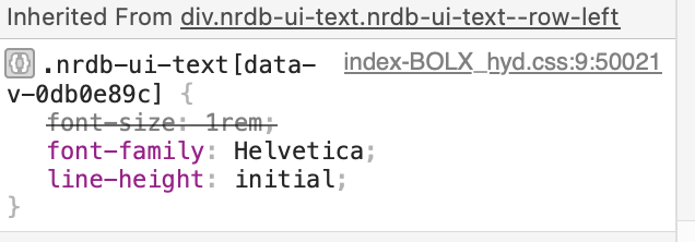

UPDATE: It appears that the ui-text widgets are ignoring any custom styles with “font-family” property. They appear to get the font family from nrdb-ui-text.nrdb-ui-text–row-left (as seen in the screenshot above). The font-size, color etc. are working as expected.
Nothing is being ignored, you simply aren't making your CSS selectors specific enough to adjust certain properties that are set by dashboard built in default styling.

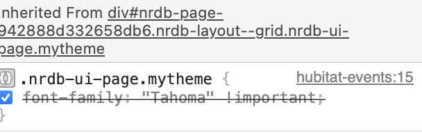

I actually have a page level style where I specify the font-family. All other elements on the page adopt the font family (group header, text input node, 3rd party widget) adopt the font but ui-text widget does not, it looks like they stay with “Helvetica” (MacOS 15.6, Safari)
.nrdb-ui-page.mytheme {
    font-family: "Tahoma" !important;
I changed the font-family to “Monaco” this is what is shown:
The ui-text nodes were in “Helvetica” (yellow) and all the others were in “Monaco” (red - as expected). I also noticed that ui-charts (line, pie/donut) don’t adopt the page level css font-family. If this is expected, is there any way to set the font at the site level?

In the inspection and style panes, I can see where the font is being assigned to this object. If I uncheck the “font-family” option, the text is shown in the font that I have specified for the page.
Is “div.nrdb-ui-text.nrdb-ui-text--row-left” (as shown in the style panel → inherited from) that should be targeted? When I click on the inspect panel and select “copy selector path” I get “#nrdb-ui-widget-c7e917035147f16e > div > label” which seems to be that specific instance of the ui-text widget. If that has to be the target, it is probably easier to use the “Apply style” in the ui-text widget configuration as there are multiple objects that need to have the same style.
