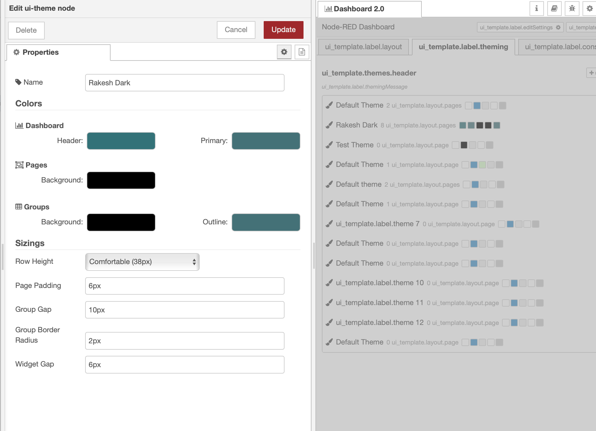

Also, should this not be a configuration option on ui-theme? I'm trying to understand why this would be omitted (not sure if this was in DB1 since I was happy with the built in font/style).

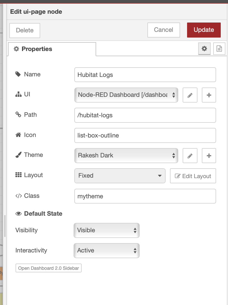

@jbudd - I don't see a place to specify a class name in the theme configuration. Am I missing something?
Apologies, apply the class to the ui-page.

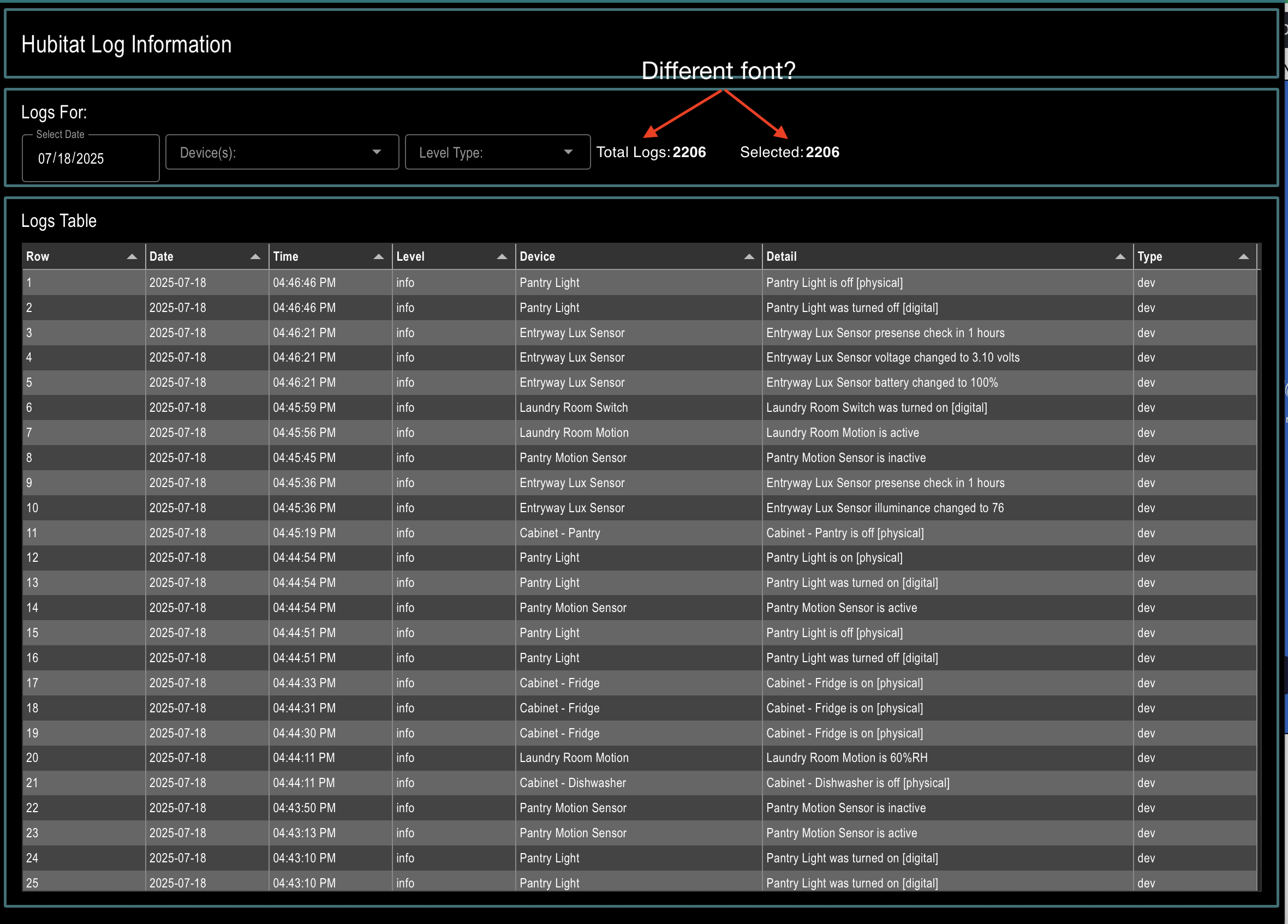

@jbudd - it seems to apply the style inconsistently (or so it seems to me)?

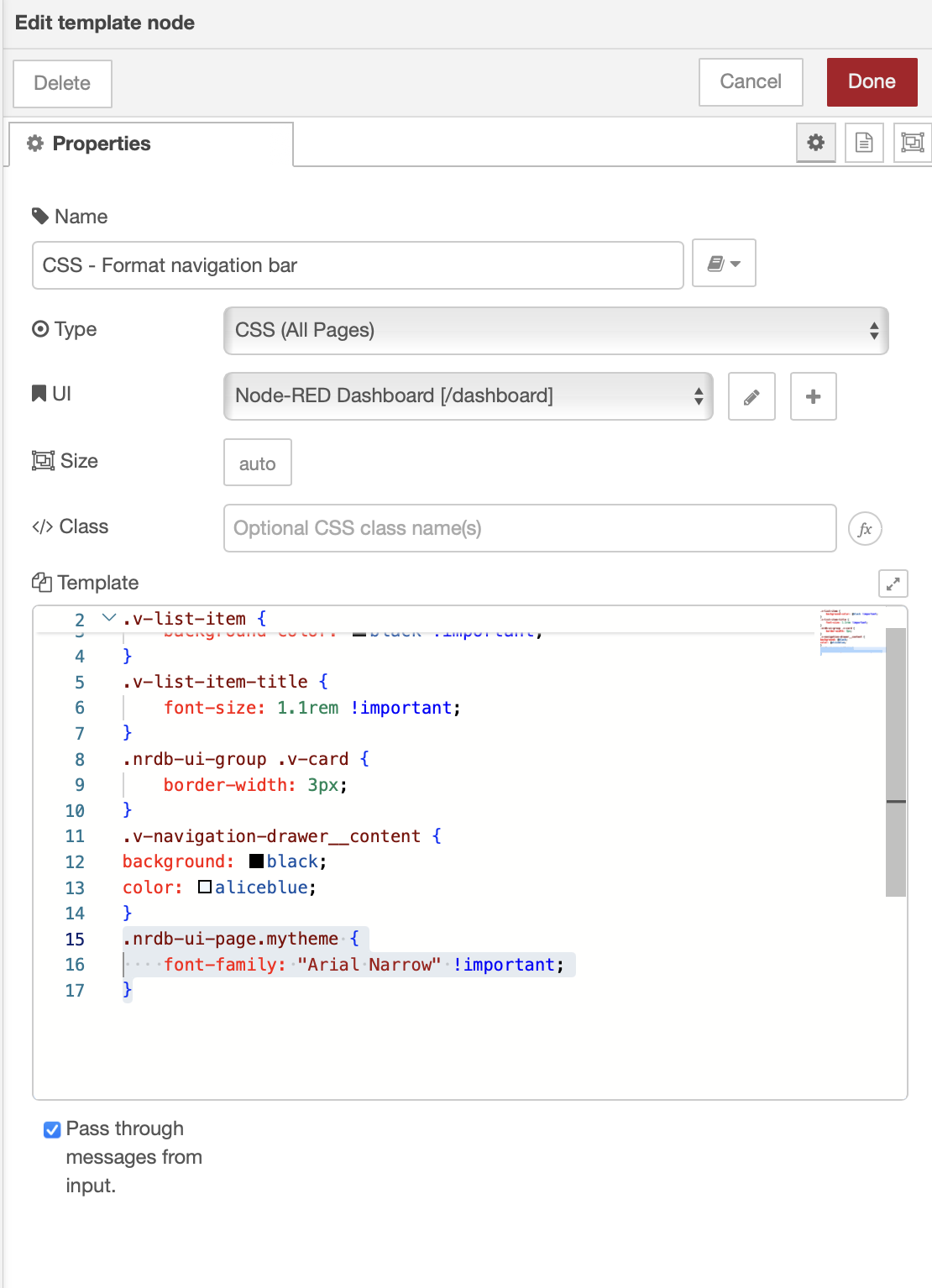

I put the .nrdb-ui-page.mytheme { font-family: "Arial Narrow" !important; } in a template node and the scope is "All Pages"

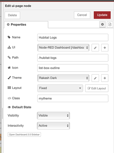

I then added the "mytheme" class at the ui-page level

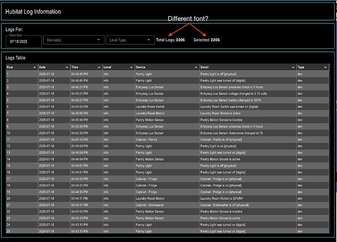

The page looks like this:
It appears that it also applied the font correctly to the ui-tabulator widget but seems to have left the two ui-text nodes in their normal font. For the third ui-text node (Hubitat Log Information), I have applied the font at the node level (Apply style) since I wanted the text to be larger. I double checked and the other two ui-text nodes have no override for "Apply style".
Any suggestions on what is going on? Thanks for your help.
It does seem surprising that the ui-text node does not inherit a font declared at page level.
You can style the text widget with this
.mytheme .nrdb-ui-text {
    font-family: "Times New Roman", serif;
This works for me but maybe it would be better to apply the custom style at the level of the groups on the page rather than the page itself. Months later it might be hard to remember where the class .mytheme comes from.
