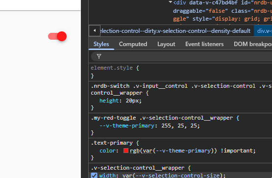

I am desperately trying to change the colours of the default icon.
I tried it with the following css class. But it does not work.
What am I doing wrong?
 * Custom CSS for ui-switch
 * Class: .custom-switch-colors
/* off */
.custom-switch-colors .v-switch__track {
    background-color: red;
    opacity: 0.6;
    /* Vuetify Standard-Deckkraft */
.custom-switch-colors .v-switch__thumb {
/* on */
.custom-switch-colors.v-selection-control--dirty .v-switch__track {
    background-color: green;
    opacity: 0.6;
.custom-switch-colors.v-selection-control--dirty .v-switch__thumb {

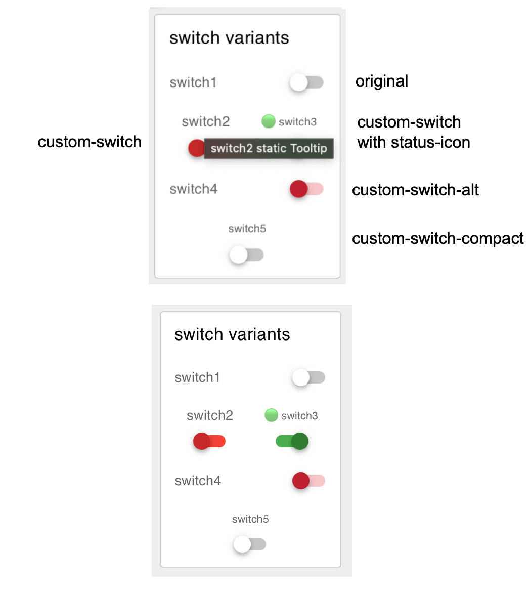

With Claude's help, I was able to find the necessary CSS selectors.
If anyone else wants to change the default appearance/behavior of the DB2 ui-switch, the selectors I found may be helpful.

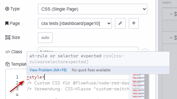

I have stored a collection of switch custom CSS classes in a DB2 HTML template node that can be used to customize the ui-switch.
The following properties are supported:
  • Compact layout - Like custom-switch-compact (4px gap, smaller margin)
  • Green/red colors - Like custom-switch (green for ON, red for OFF)
  • Label above switch - Vertically centered Hover effects - Static or dynamic tooltip Support for status icons - Icons are not cropped
A detailed description can be found in the description of the template-node.
Prerequisite in the ui switch
When using custom classes, the layout setting must be selected as shown in the image:
One more warning.
I am not a web developer. And even though the classes serve their purpose for me, there are certainly more optimal solutions.
Perhaps someone has a tip on how to define the classes independently of the layout setting in ui-switch.

In a CSS template, you should not be including HTML tabs
To affect the colour, you can locally override the CSS variable that affects the colour.
.my-red-toggle .v-selection-control__wrapper {
    --v-theme-primary: 255, 25, 25;
Proof:
chrome_wKMchw6CQb
Thank you for this tip and the example. You are right, this is certainly the better and more flexible option.
I thought I could save time by using the standard switch. But as soon as major changes are required, that's not the case.
Thank you for this tip. I did not know that.
Great. Can you tell me how I can change the colour for the off state in a similar way?
Same - adjust the variables that affect them. You simply inspect the elements in your dev tools, find the name, set their value!
    --v-theme-surface-bright: 0, 255, 255;
    --v-theme-surface-variant: 0, 255, 255, 0.5;
chrome_hGkJDieYsM
I still have a lot to learn. Thank you
