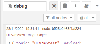

The time, topic and source node are already shown:

So unless I've missed something, I think everything you want is already there?
If you want more things in the output, simply add a node to add additional properties to the msg going to debug.
