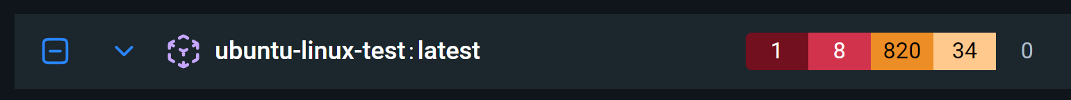

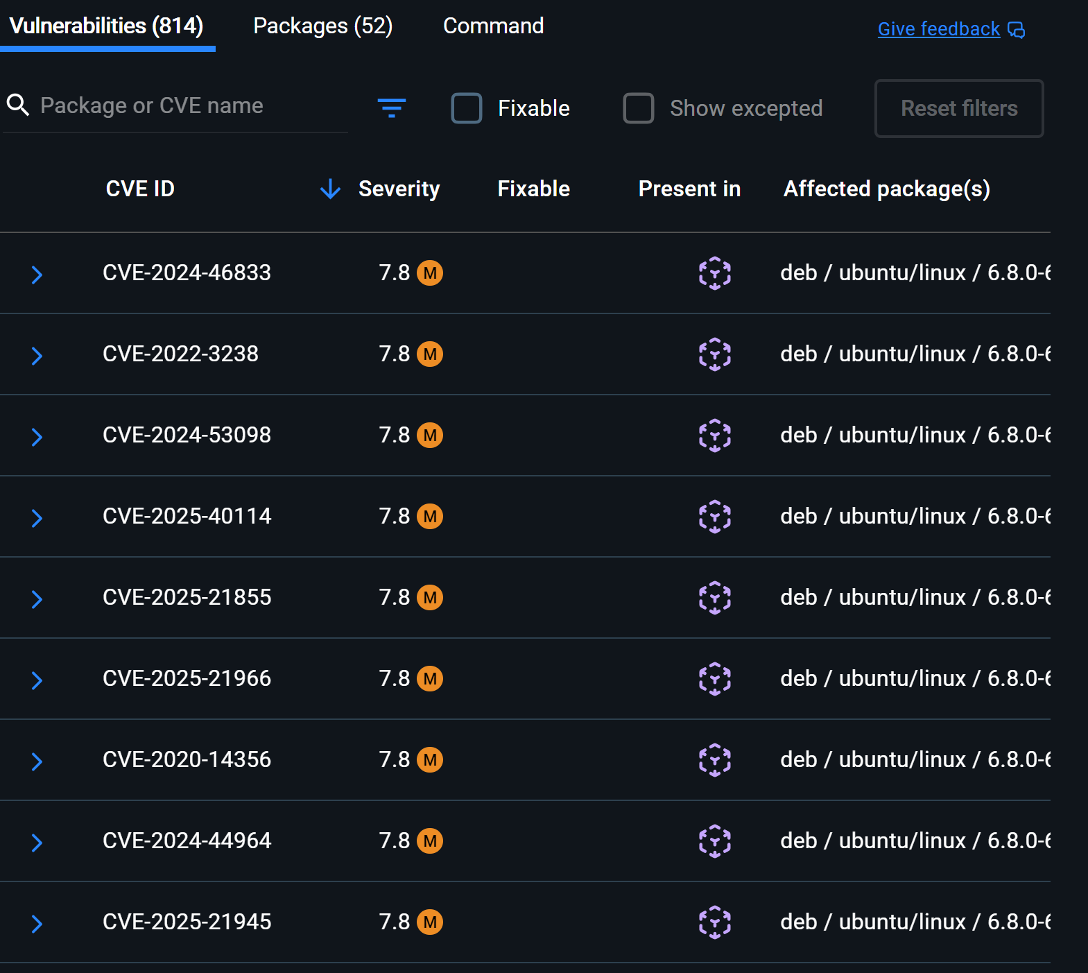

I have scanned with Snyk but have currently settled on using Docker Scout
814 vulnerabilities flagged in g++ and its dependencies.
Build-essential and clang seem to have similar issues rasied against them on Ubuntu anyway.
I agree core nodes do not have that dependency...
At least some of those (from a very quick check) relate to Linux itself so I'm not sure that the risk is what you think it is. Not saying there aren't any risks but you should check, as Colin suggests, that you need to check build-essentials for issues. You cannot lay the issues of Linux against the door of node.js.
